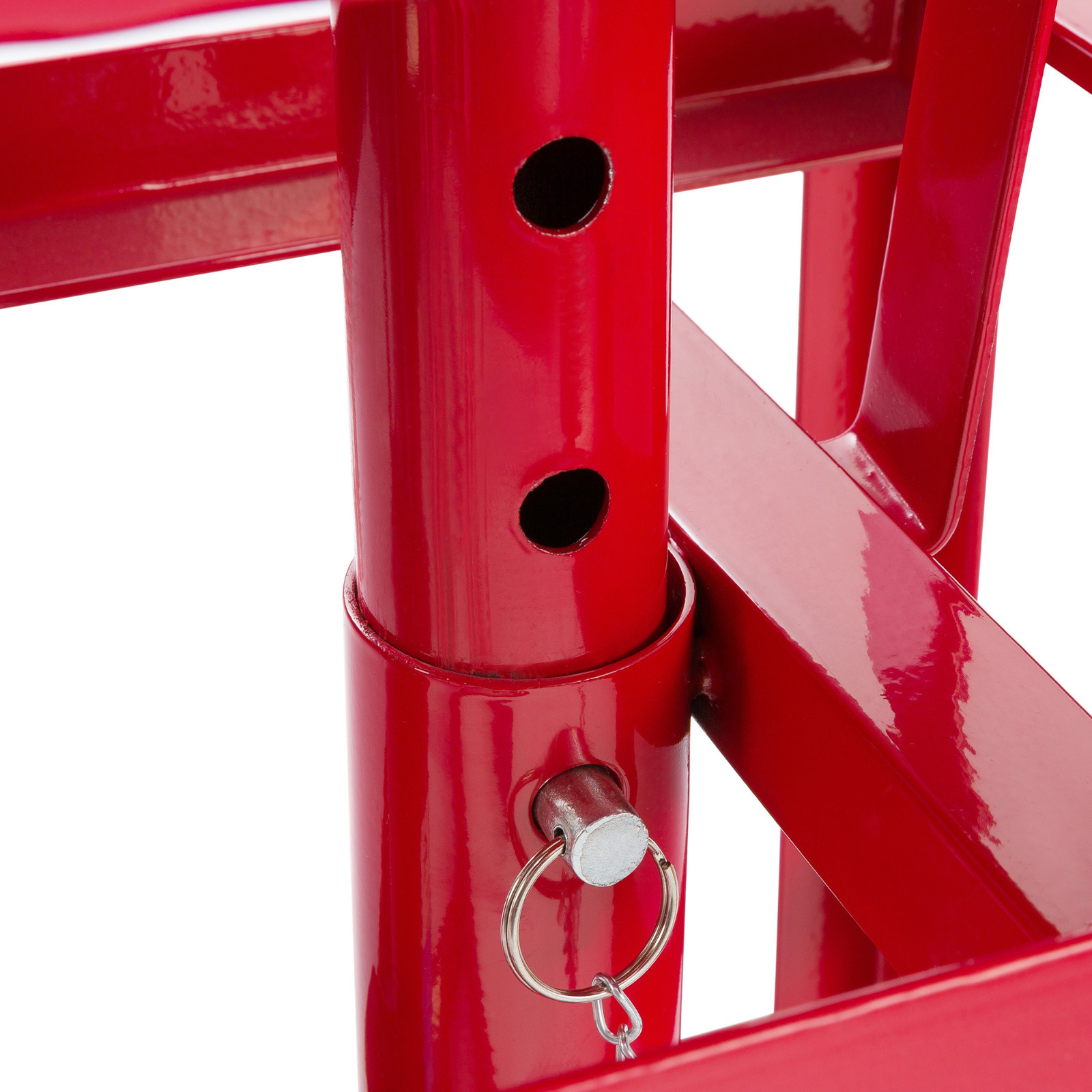

Those red ramps earlier in the thread worry me though with the little bars on the sides which seem to be welded (poorly) onto the sides of the ramp... Pretty crap!

I'm wondering too, if the newer ones, intetnionally have more structural elements/welds , to allow for them being inferior .. it still works if one weld goes
Yes, whoever designed it didn't think about what happens if the welds let go. The struts will just ping off.

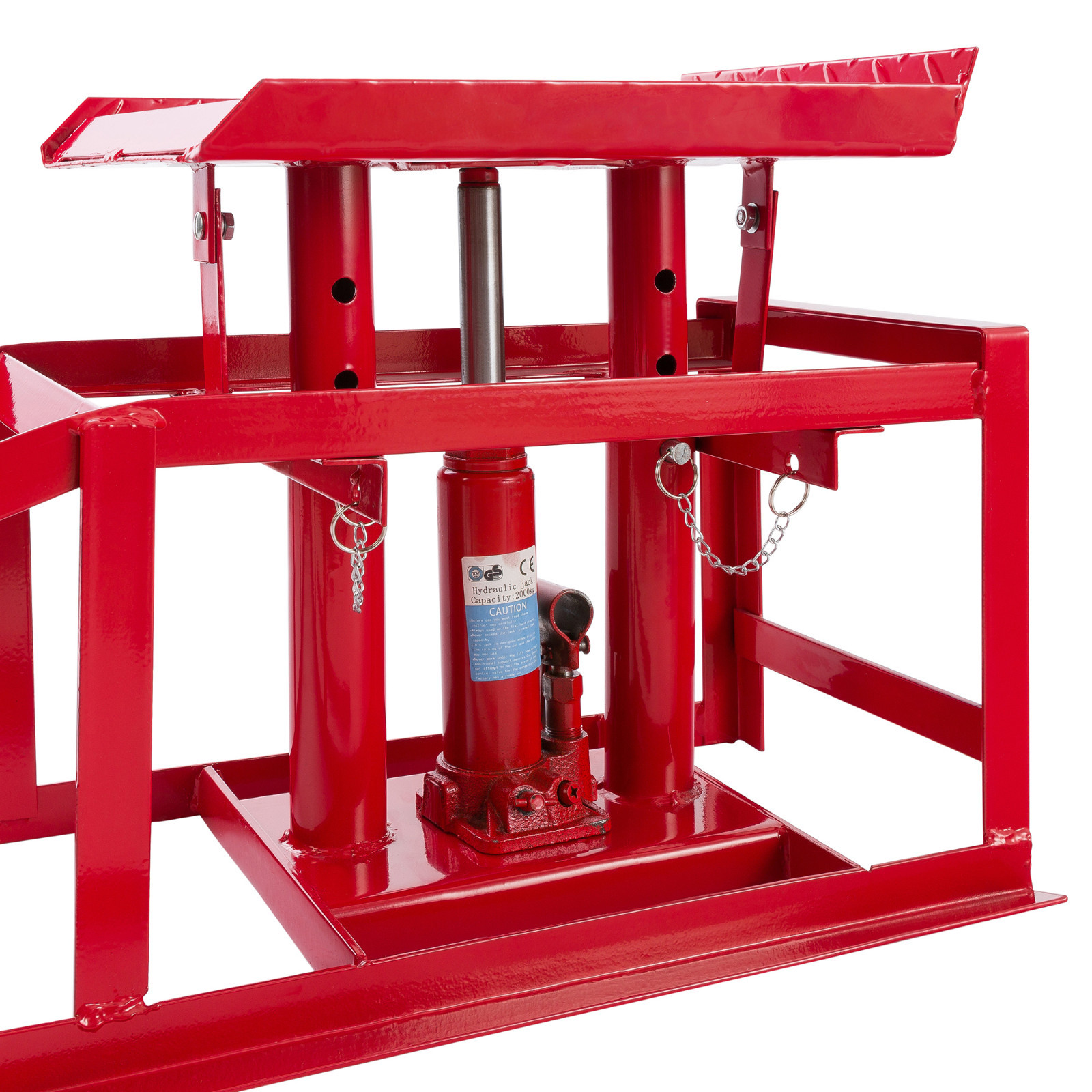

And also a hydraulic lift built in to them. You'd need axle stands to use that safely, which kinda defeats the point.
It's not really that, is it though ? ..that would be a horrible and unsafe multi purpose - a jack of all trades. ..
it is just vertical uncompressable steel sections taking the load directly.

I think it is a hydraulic one. Just without the bottle jack in those pics.

no way on earth I'd be raising my car on that hydraulic section, with the close up the state of the welds , and lack of stability if the car got pushed sideways, especially if you had one on both sides
thh bottle jack might have a ce stamp, but the rest of the structure ? it was made in Germany, not by acme ?

BTW - The entire red ramp is TUV Sud certified - i guess you never heard of them but they are a compliance authority in Germany, I guess if your fantasy scenario occurred then TUV would have much to answer for...

I'm sure they are strong enough to be safe and pass certification, but they are still poorly made and designed with what appears to be very little understanding of how to make something inherently strong.

Shipped from Germany but made in China lol. There is only one place making these and its in China. How do you know its really TUV approved, because they said so?
That welding is no way up to the German standard.
Ebay is full of stuff with fake certificates and "CE" stickers.
