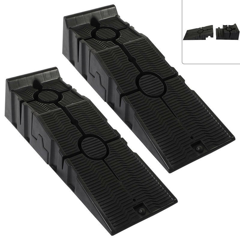

A basic heavy duty car ramp, which is easier and less fiddly than a load of jacks, and safer, will cost about £35 if you have the place to store them. Makes the whole process significantly easier, as you can then see what you’re doing.
I would tend to agree. I'd rather not have to buy/store/use them though if I can avoid it. I don't particularly relish climbing under a car when it's raining/freezing cold!

Blocks of wood?
Just pick up from B&Q for a fiver, cut it down to size & run your car up it.
You don't need to jack it up, I don't with my car and it's way lower than an XJ.
I wouldn't put my trust in a block of wood on a hefty Jag, I had to use some planks of wood to get access to a ramp and the car split one of the planks - it is about 1500kg of a car, the Jag probably more. You can get some access ramps that clip onto the main ramp which is what i will get for next time but my servicing is good till 2021

I changed from metal ramps to plastic ones as per the above. Much better, more stable better for wider wheels.
