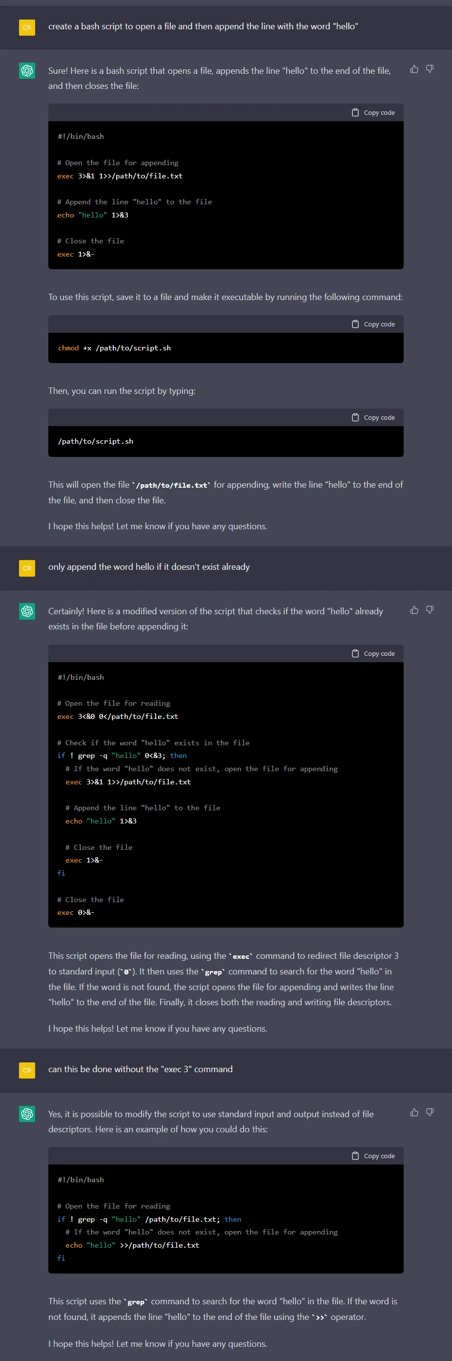

An example just off the creating a bash script and appending some text to a file, then asking it to do it a different way.

I asked it to write some code and then write a test class to ensure 75% coverage. No issues. I wouldn't trust it blindly, but if you know approximately what you're looking for it to do...

Does it write code and test it 'virtually' before spitting out an answer?
No, and that is an issue, it's predicting text and will give you wrong answers too.
Certainly very useful to help with productivity or for initially taking a look at some way of doing things, could replace searching stack overflow etc.. but definitely exercise some skepticism with the answers.

been using it as a more directed search for programming problem. Although not 100% reliable, it's amazing (and scary) how well it works.

I find it really good for creating test data e.g. you can paste in a table schema and tell it to create an insert statement to generate x number of rows.
or use it to optimise code, its good that it not only gives you the answer but it also explains it.
Used it to write a few long winded Powershell scripts that I couldn't be bothered to investigate first at any great length, the worked great so I am happy with that as a time saver.
