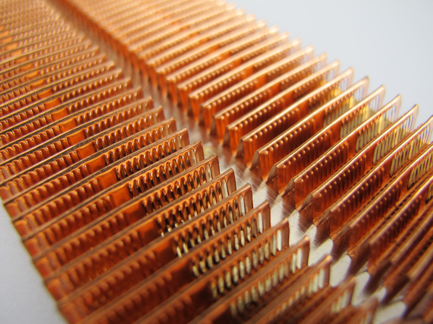

Waiting for next Gen of the Product. most likely go 4 chambers and single 140mm heatsink design . slightly thicker . Dual Noctual/Silent wing 140's on it and boom!
one shown above (Proto) and production version
as above this this could be easily cut down for single 140mm fan or dual for push pull and keep the same height but drop 100mm in length
chamber design, moving from 2-3 , again easily get 4/5 in there
lastly to improve on the fin design which has already been increase one, by using same design on Water rads instead of solely on flat plates above. Need better static fans but surface area increase by 50-10% depending on Fin Per Inch
orbitalwaish
Maybe I'm missunderstanding what you posted, but I don't think they could 'cut down' finpack housing to fit 140mm fans because it's made for smaller 120mm fans.
Where is that last image from? Could you give us a link?
