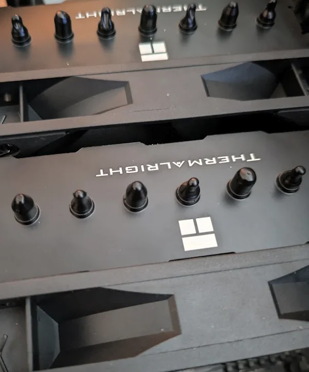

All sorted and really happy with this cooler.
Idle has dropped 20-30 degrees. Not tested any games yet but on boot it was hitting 90 before settling down, hits 50 now.
Hence I needed a new cooler...

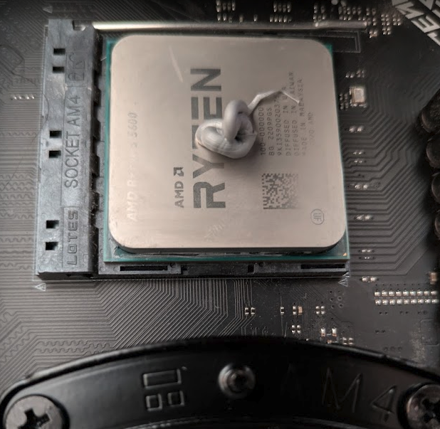

What processor is it cooling?
Only a 5600.
I was using the Wraith cooler that was supplied with the CPU.
I did clean it out and re-pasted with Grizzly which helped a tad about 6 months ago. But really, it's never been right for intensive games.
On buying a new GPU I had to get a decent solution.

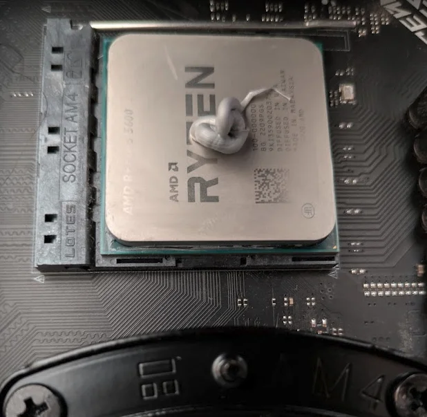

I think you used a bit too much paste though, but that's a topic for another discussion lol.
Well you need to use a "pea" shaped size.
And it came out as a stream.
Did what I could do!
When I've used as much as you did, on AM4, it's ended up welding itself to the HS whenever I goto remove it - even if i've ran the PC for awhile to warm up the paste, then it rips it out of it's socket risking damaging the pins on the CPU, all whilst still attached to the HS.
You'll find a load of paste will have gone over the edges to the socket, when you eventually remove it.
Next time you remove it, have a look and see if it has overlapped the edges of the socket, my moneys on that it has. Hopefully it doesn't get stuck to the HS when you do.
FWIW, I'm not trolling you, it just scared me a lot when it happened to me, as the socket was still locked shut, and the CPU would not let go of the HS, and this wasn't a one off occasion.
These days I just use a credit card and smooth over it evenly - I found a significant difference in temps, IIRC around 6-7C when I last did a repaste that way versus a pea or smaller; as I did a back to back test one day, and was glad that I did.
