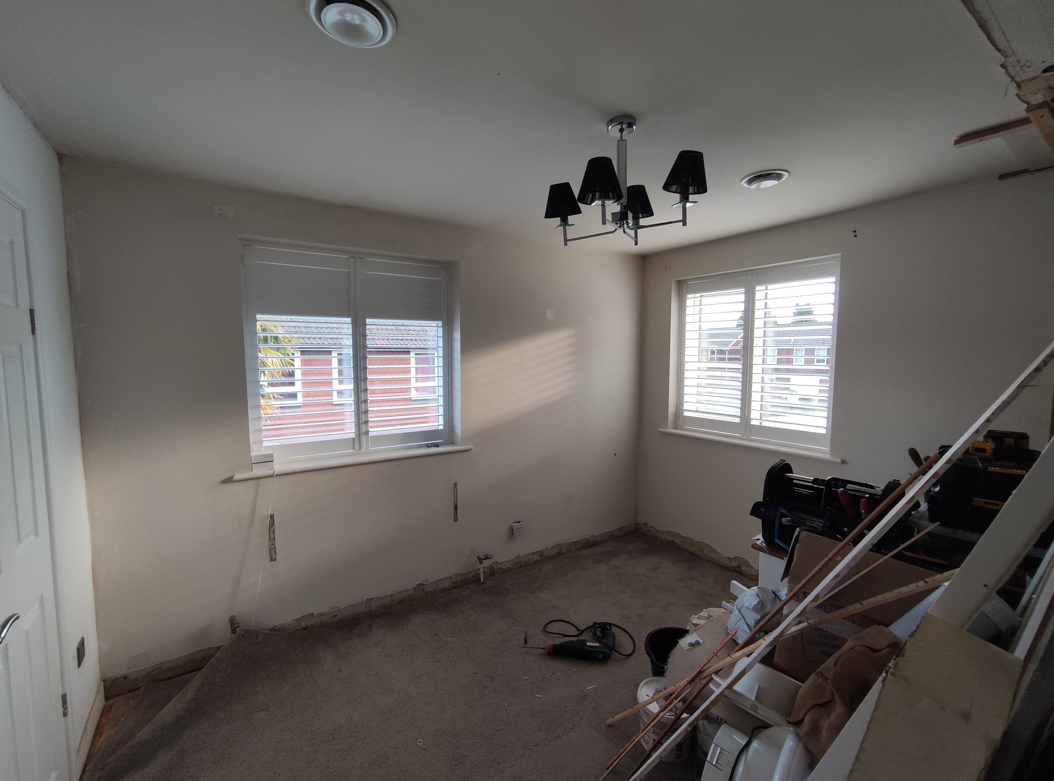

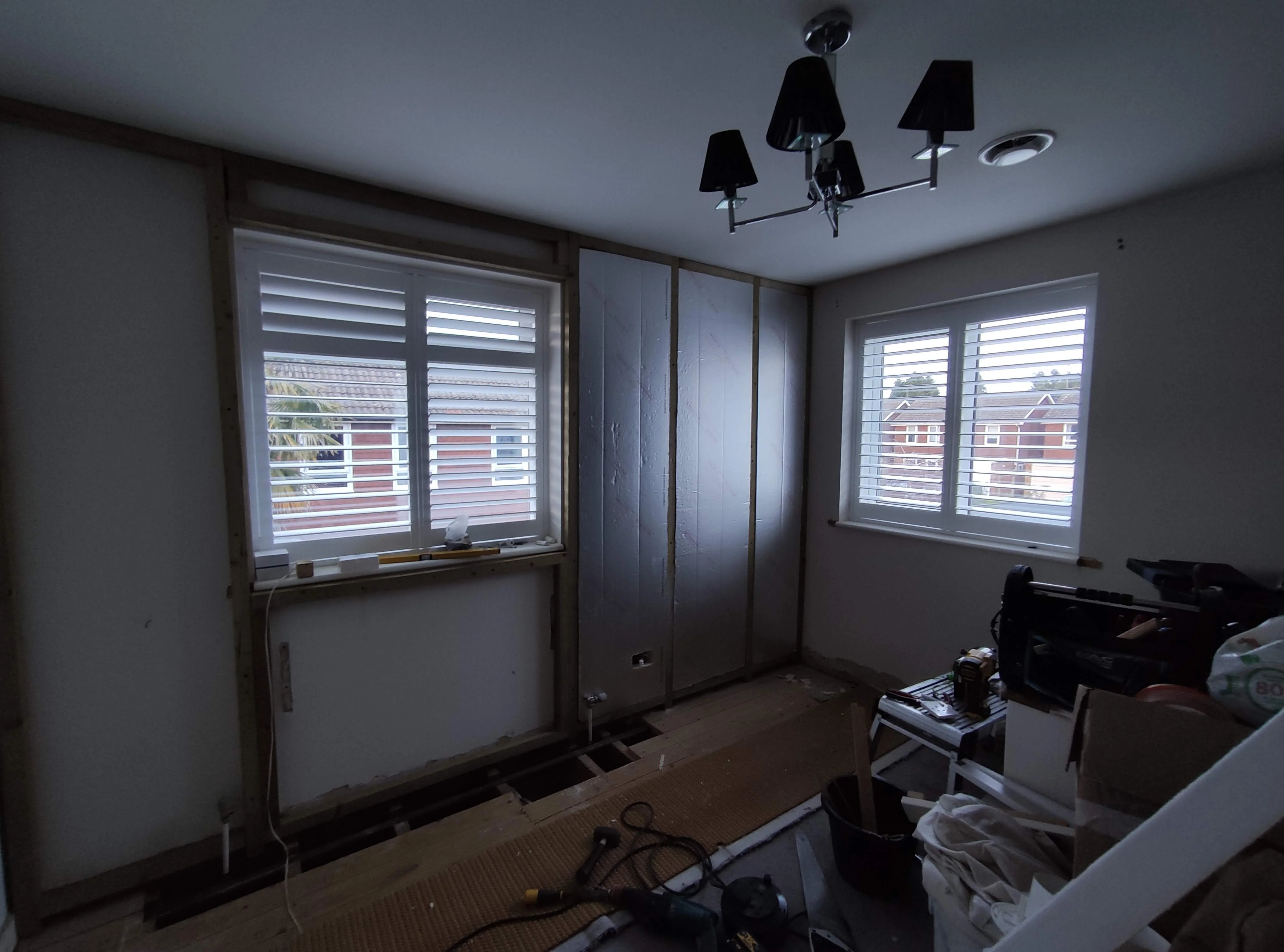

Anyway, made a start on the walls here today, not as much progress as I'd like to have made, but few annoyances with the current rad pipework being enclosed by the water pipes and nailed down.....Put my foot through the floor with a minor slip, luckily it was above our porch so just into another cavity that i'd already filled with wool insulation!
Before
After
Nails...

Looking good really starting to regret I did go down this route when I moved in.
Should be a whole load better than it was before.
Should see fairly quickly as I've had a Temp/Hygrometer in the room for the last month, so will be able to tell quite quickly if it's working, although to the right of the photo is some plasterboard that is falling down that I had to patch up, which probably isn't helping with the c. 65% humidity!
