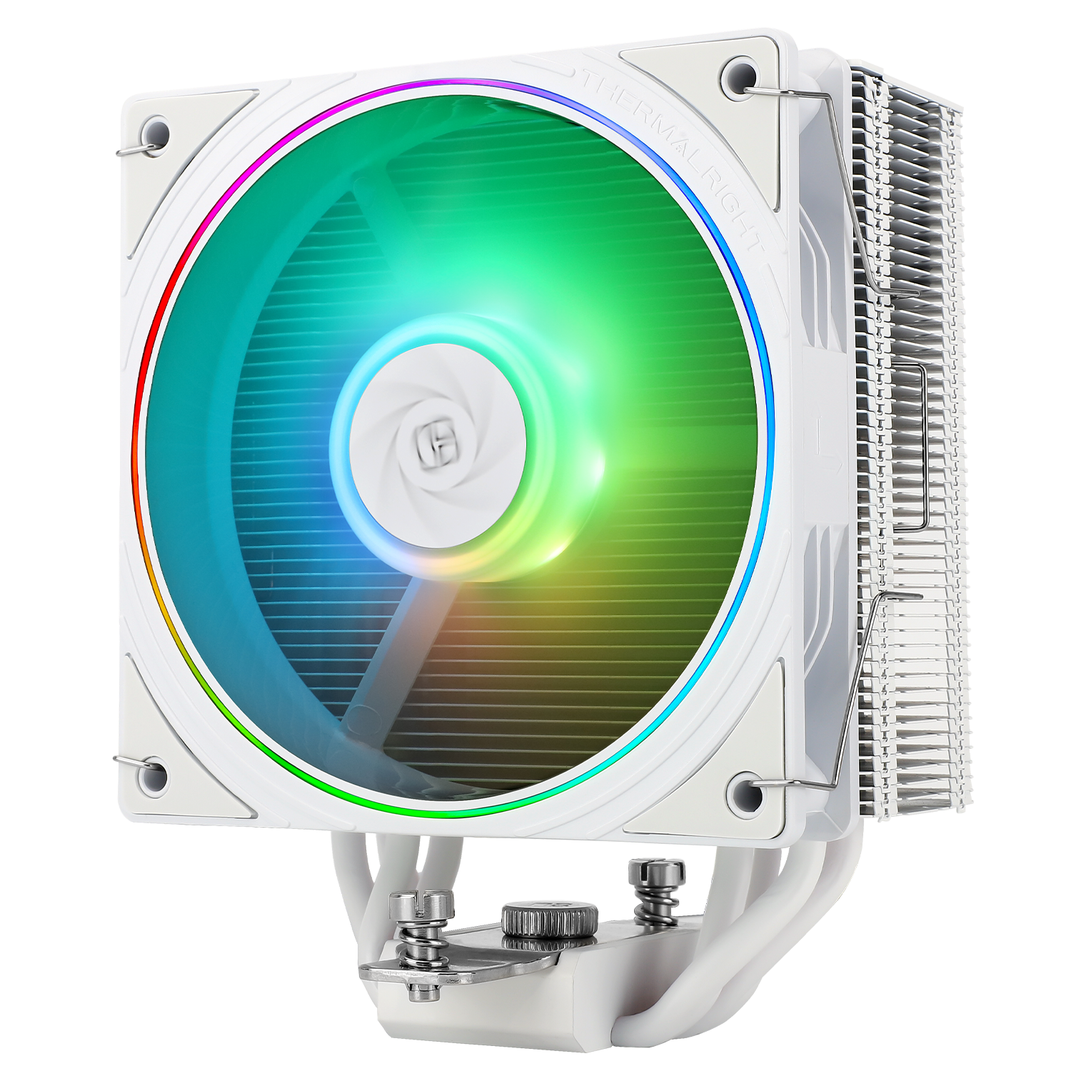

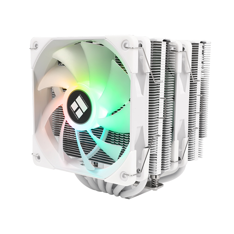

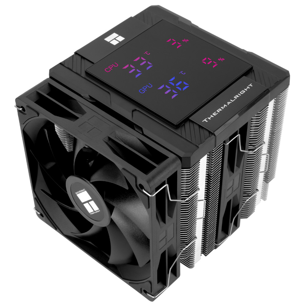

this is not needed some with come with the new cooler.
id swap this for an PA120 air cooler and save £70 for a 7800x3d it just not needed

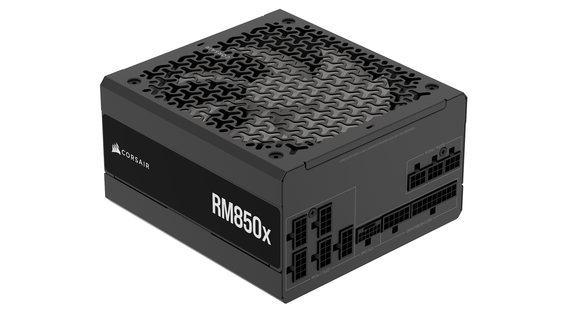

buy a branded 850W psu for the same price or even cheaper, i just dont trust Aerocool

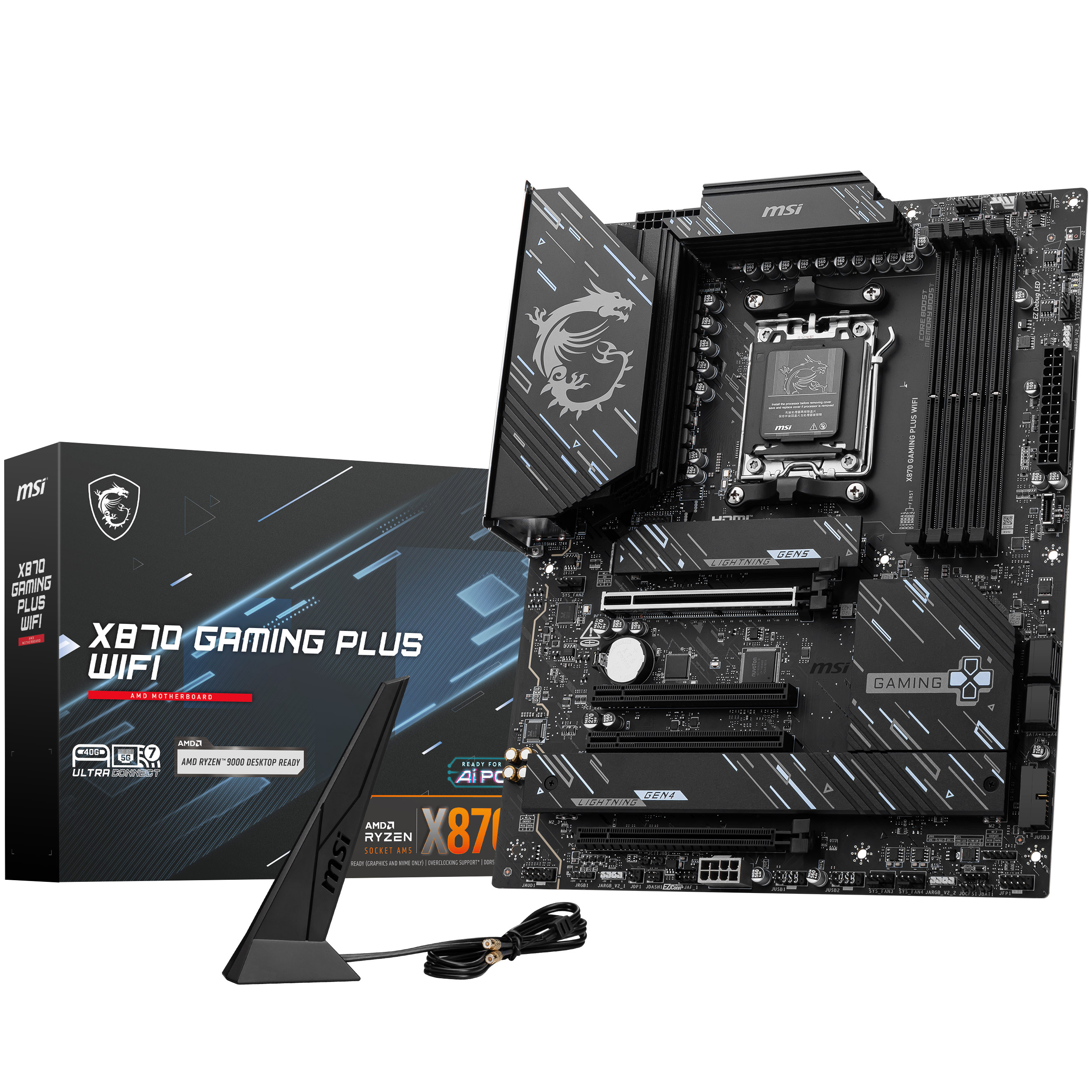

No, i have no idea what that is. i meant that the gpu can connect and also a hard drive can connect with pcie5. I just wanted these to both be connected via pcie 5 so the whole setup lasts longer.
The board has one PCIE 5.0 M.2 slot and the primary slot is PCI-E 5.0, so yes, that is possible. But, like I said, unless you know you need the PCI-E 5.0 drive (e.g. regular large file copies), they're not needed and won't do anything for you.
PCI-E 5.0 graphics might have a benefit in the future, but right now, it is just a few percent loss in performance on a 5090, if you don't have it.

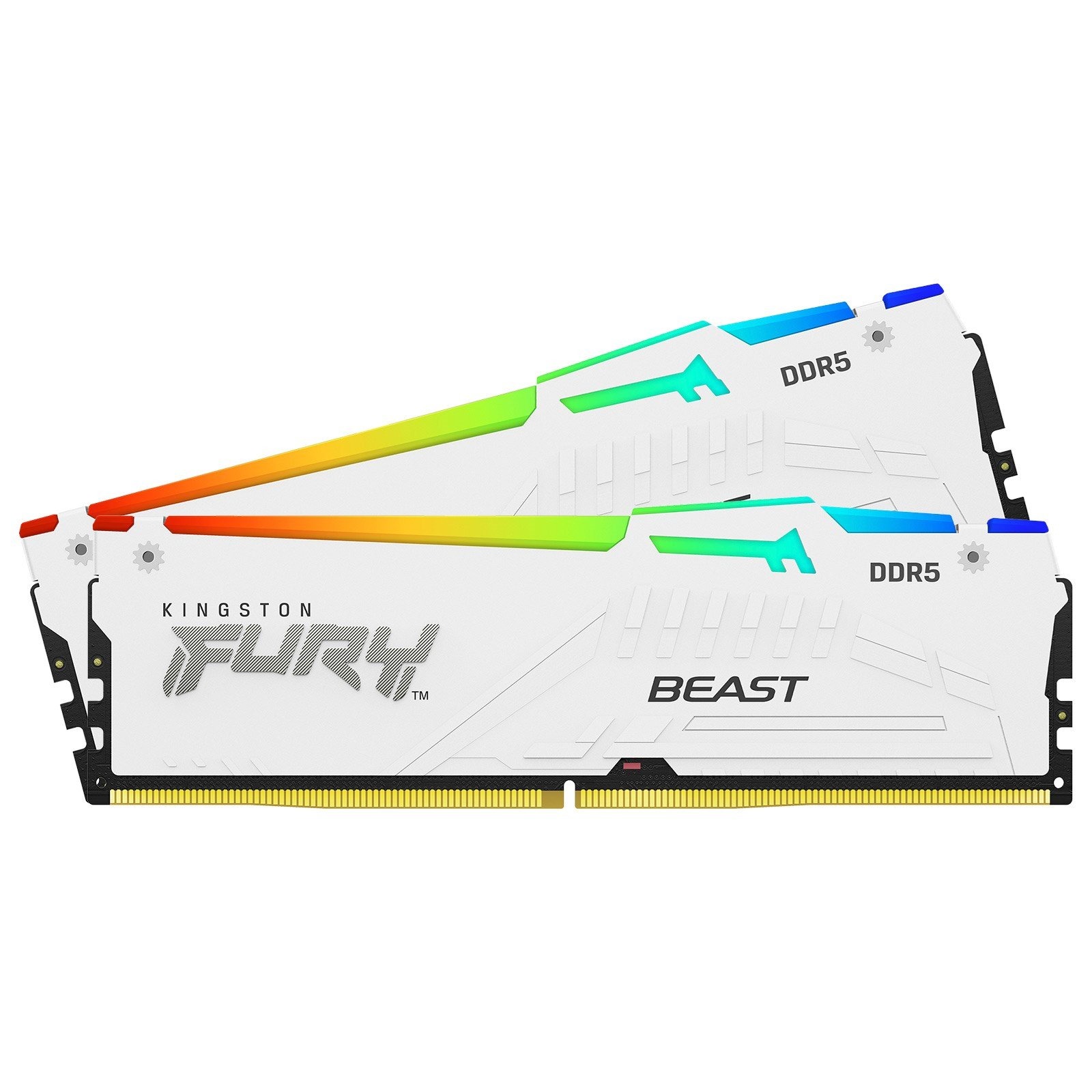

I'd be aware that DDR5 systems don't much like running 4 sticks, so if you think you'll need it (some games can push it, particularly modded games and city builders) then I would buy it now.

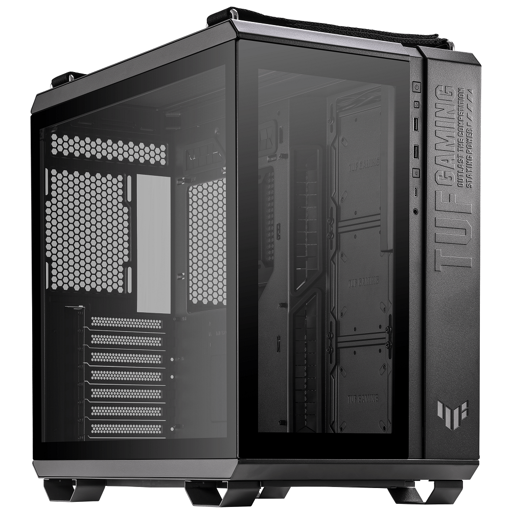

The TUF Gold is on offer quite a lot, worth a thought.

My opinion is that you're likely to get better long-term value from putting the extra £100 into 64GB of memory, than you will from a PCI-E 5.0 drive, but I know not everyone would agree.
psu makes sense. I'll keep the ssd but swap the ram anyway as i'll be cheaper on graphics.

Change the case as it does not come with any fans, so you have to add that cost on top.

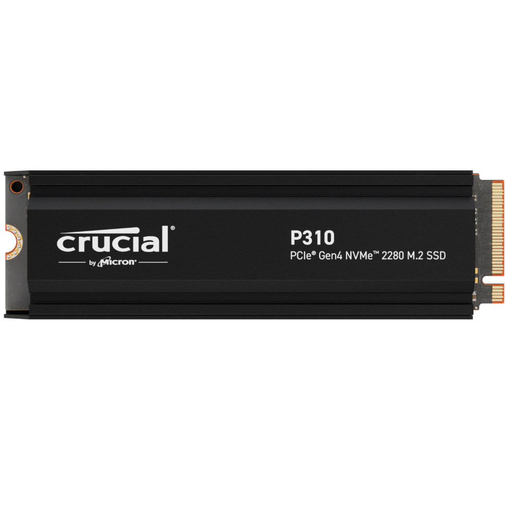

You have listed a NVME drive with a heatsink, get one without so it will fit under the motherboard plate.
Have also put in a cheaper PSU, but only has 8 year warranty compared to the MSI 10 years.

If you like the cube style case, maybe look at Antec's C5 ARGB, which includes 7x 120mm fans.

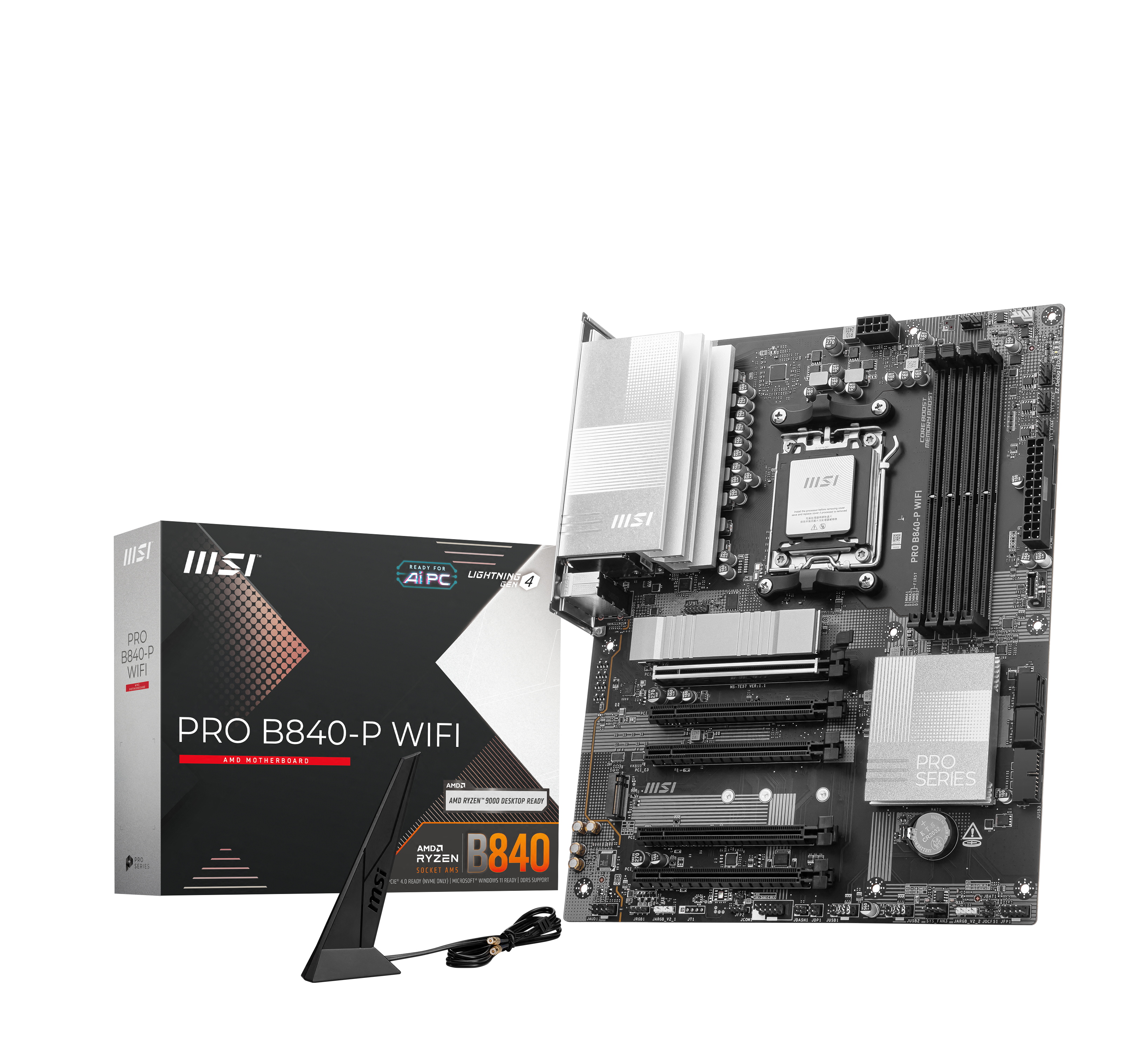

You could go B650 and save a bit more, but B840 should have BIOS support out of the box, if you don't like updating.

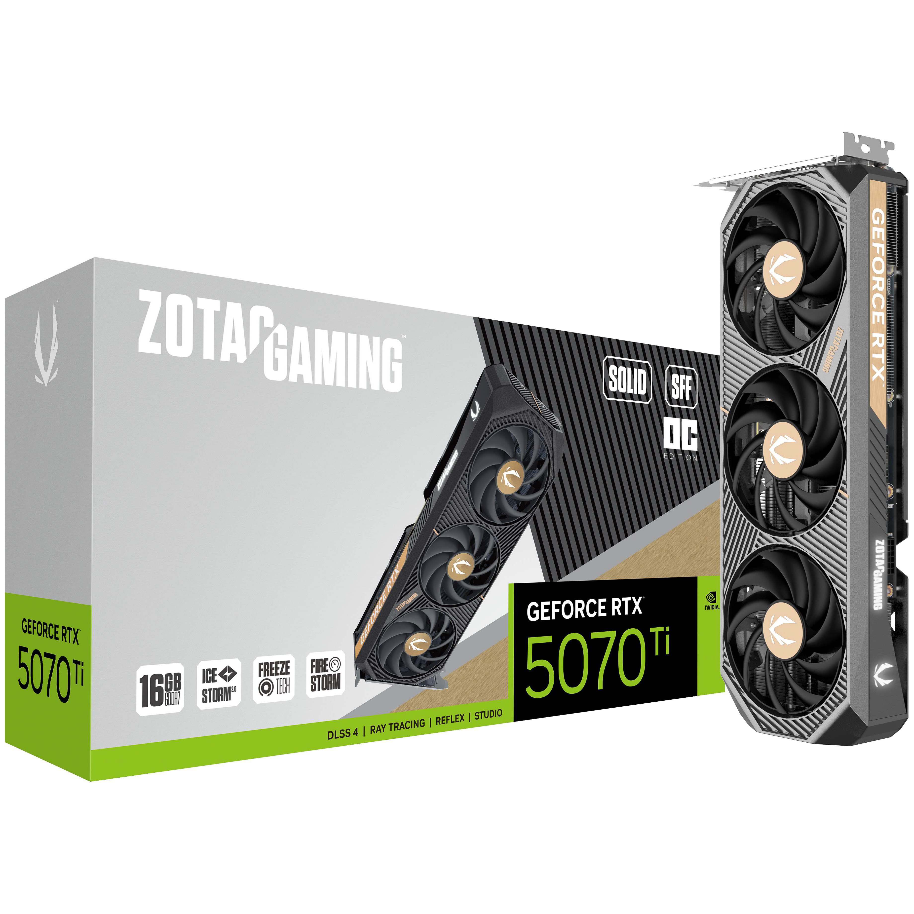

I'd suggest the 9070 XT as already mentioned, but here's a 5070 Ti if not.

plenty of cases with rgb fans in them if you want that aren't as expensive as the tuf case...and tuf case be fine with an air cooler..it's another take on the 011d, which i have with an air cooler and looks fine. I'd just say goldfish bowl type suit rgb more than standard cases as the idea is you look inot them

I'd take a b650 board over a b840...b840 is an a620 chipset so can't enable pbo as no cpu overclocking...you enable pbo in bios...literally turn it on and done so no messing around.​
