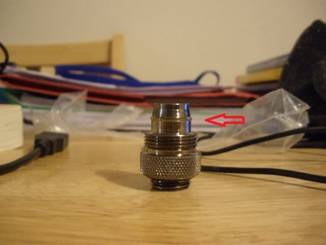

Hi guys I am doing a rebuild at the moment and have for the first time since I started watercooling have decided to use compressions.
Now I have built my loop and leak tested and there is non. However I am concerned I haven't mounted the tube correctly. I am using EK Compressions (there very nice by the way). On the nozzle there is a knuckle about half way down. I have pushed my tubing up to the knuckle but not over it and tightened the fittings and all seems good. However I'm doubting myself and wondering if the tubing should be pushed right over the knuckle to cover the entire nozzle?
Thoughts please?
Here you go red arrow points to what I mean by the knuckle and as far as the tubing goes.
If you have the correct tubing for the compression fittings it shouldnt need heating up it should slip right on there just needs a little force

Bit risky but if it were me I probably wouldnt drain the system to fix this. I'd probably just unscrew each compression fitting & push the hose on correctly then screw it up again. Draining the loop imo is too much hassle. I had 2 leaky compression fittings in my last re-build & I changed them without draining it. Only a bit of water came out which I'd prepared for. 1 was the fitting on my cpu block, the other was one of the fittings on my side rad. laws of physics wont allow water to gush out as long as the rest of the loop is sealed because there is no where for air to rush in. Worst case scenario in your case is a drip or 2 :)
EK compressions have seemed pretty tight on all tubing i have used, i think they just make them a touch bigger than others.
after i tightend my compressions onto the tube, there was no way of getting them back off without cutting the tube and undoing them from the blocks or rads......i then had to pull the tube off the compression fitting with it still screwed in......the blummin things just wouldnt undo.......
I've had tubing in the past that didn't want to allow the compression fittings to unscrew, but the Masterkleer tubing is pretty good at allowing the compression fitting to unscrew.
Just check your not over tightening the fitting, finger tight should be more than adequate.

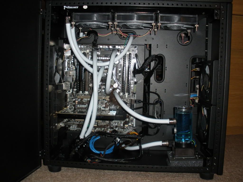

Thanks all build is done now just waiting for my temporary gpu to arrive, no more gtx 480 sli for me:(
Mobo is asus x79 sabertooth, with koolance blocks and rads throughout.
Roll on Keplar :)
Should be two pumps in there as well but one of them was dead, not sure how long it has been dead for as it was in my old build but didn't work in my new one. One of the disadvantages of running two pumps off one pwm header:(
