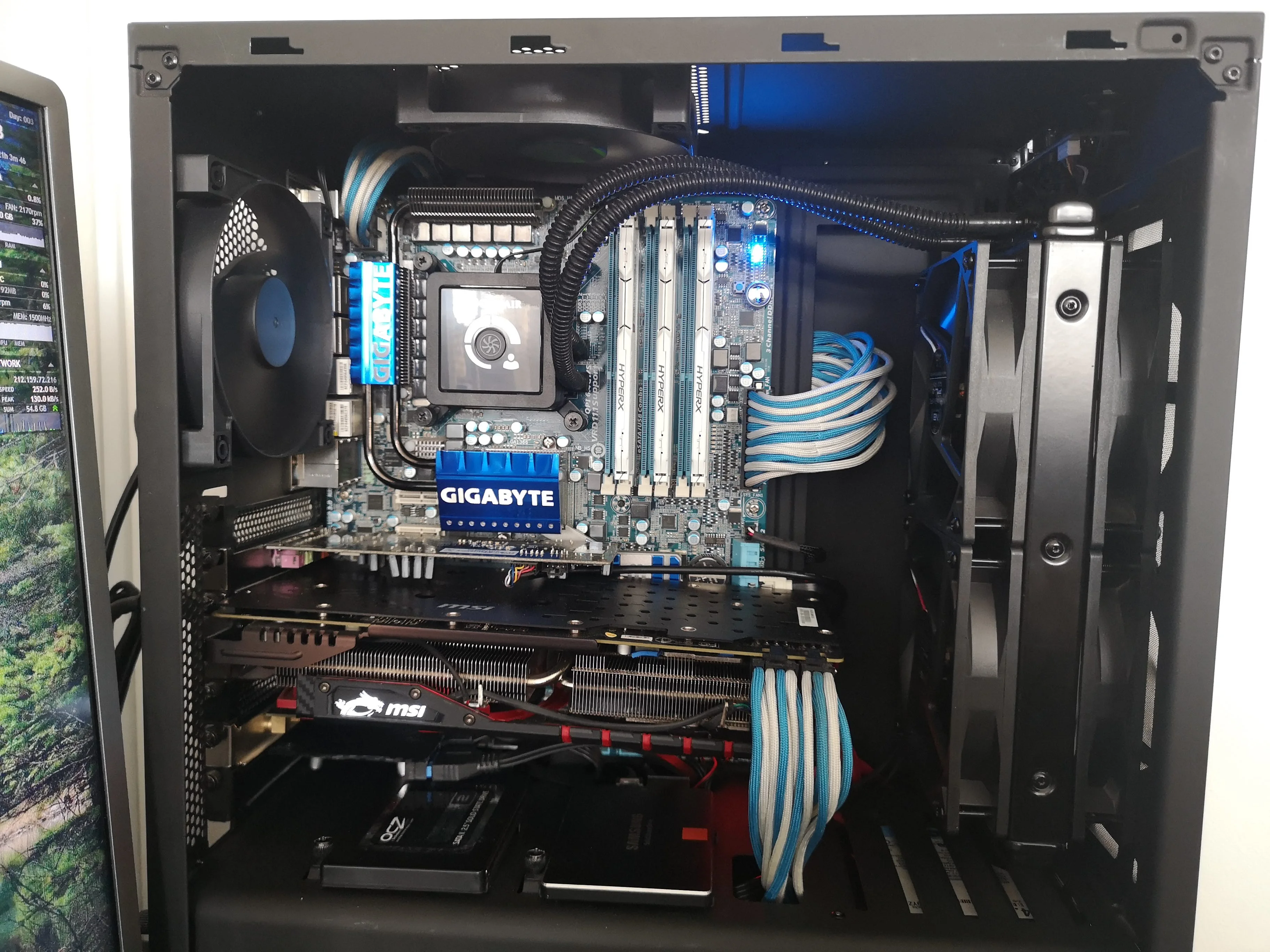

So I'm experience problems of my GPU hitting thermal throttle. I'm not sure what to do next. The only way it'll run OK is with the side of the case off.
NZXT S340, H100 CPU cooler with 4x Noiseblocker PL-2 fans running full speed.
Standard NZXT exhaust fans, one rear, one top.
The Noiseblocker fans are 96m3/h which is 56cfm. I haven't seen many fans more powerful than that https://www.blacknoise.com/datas/downloads/datasheets/TData_BSP120_122012_de_en.pdf
I've either got to find another way to cool the old 390x, or increase air flow within the case.
I did think about finding a better case, but it needs to be small and full ATX.
Any suggestions please?
I don't think he can as it looks like there is only room for one 120/140mm fan.
Oh yeah sorry I didnt look closely enough, other than a repaste for the GPU as suggested there isnt much you can do other than start throwing money at it.
Do you have an air cooler you can try or buy a cheap air cooler for the CPU and remove the AIO to see if that resolves it?

- Repaste GPU if not done since owned
- Remove slot cover that is immediately below GPU
- Change slot spacing e.g. move the sound card up 1 slot, and/or move whatever is in the slot underneath the GPU (wifi card?).
- Possibly try disconnecting top exhaust fan / so that less air is sucked out of the top, hopefully pushing more towards the rear (may need a higher CFM rear fan)
- Replace the 390x with something newer and cooler running?
To answer some questions;
I re-pasted the GPU last this week which made no difference.
The H100 can only be mounted in the front. Don't think I have my old air cooler to test.
I'll remove the WiFi card and see if it makes much difference. Doesn't really get used anymore anyway.
The PCI slot covers are holed.
The sound card cannot go in any other slot.

Even a much better case won't necessarily help a hot card like a 390x that much. Chucking lots of fans at the problem isn't really the answer, better answer is to get the airflow where it's needed i.e. over the card.

Worth noting than although they are fairly high in terms of cfm, I might be wrong but I don't think they are particularly suited as radiator fans, as they don't have that great a Static Pressure 1.24mm/H2O
EK Vardar, BeQuiet Slientwings, Noctua all make fans with higher Static pressure that are perhaps better suited - someone more experience with Watercooling/AIO coolers would be able to make a better recomendation than me however.
Top fan off, WiFi card out, no difference.
Did the system get any hotter with the fan disconnected though? If not, then it might suggest that there isn't enough intake air (e.g. because you need Fans more capable of overcoming the "blockage" of the Radiator)
The Noiseblockers were the only fans I had 4 matching to try. They replaced a pair of Corsair SP120 Quiet Edition fans which have a static pressure rating of 1.29, so not much different.
The CPU cooling is fine by the way, only changed the fans in an attempt to increase the air intake.
It didn't get any hotter with the top fan off, as soon as it throttles it sits at 94
I have hardly any airflow in my case at all due to the case design (Evolve ATX) and an AIO - My gfx card sits around 50-60 full load.
