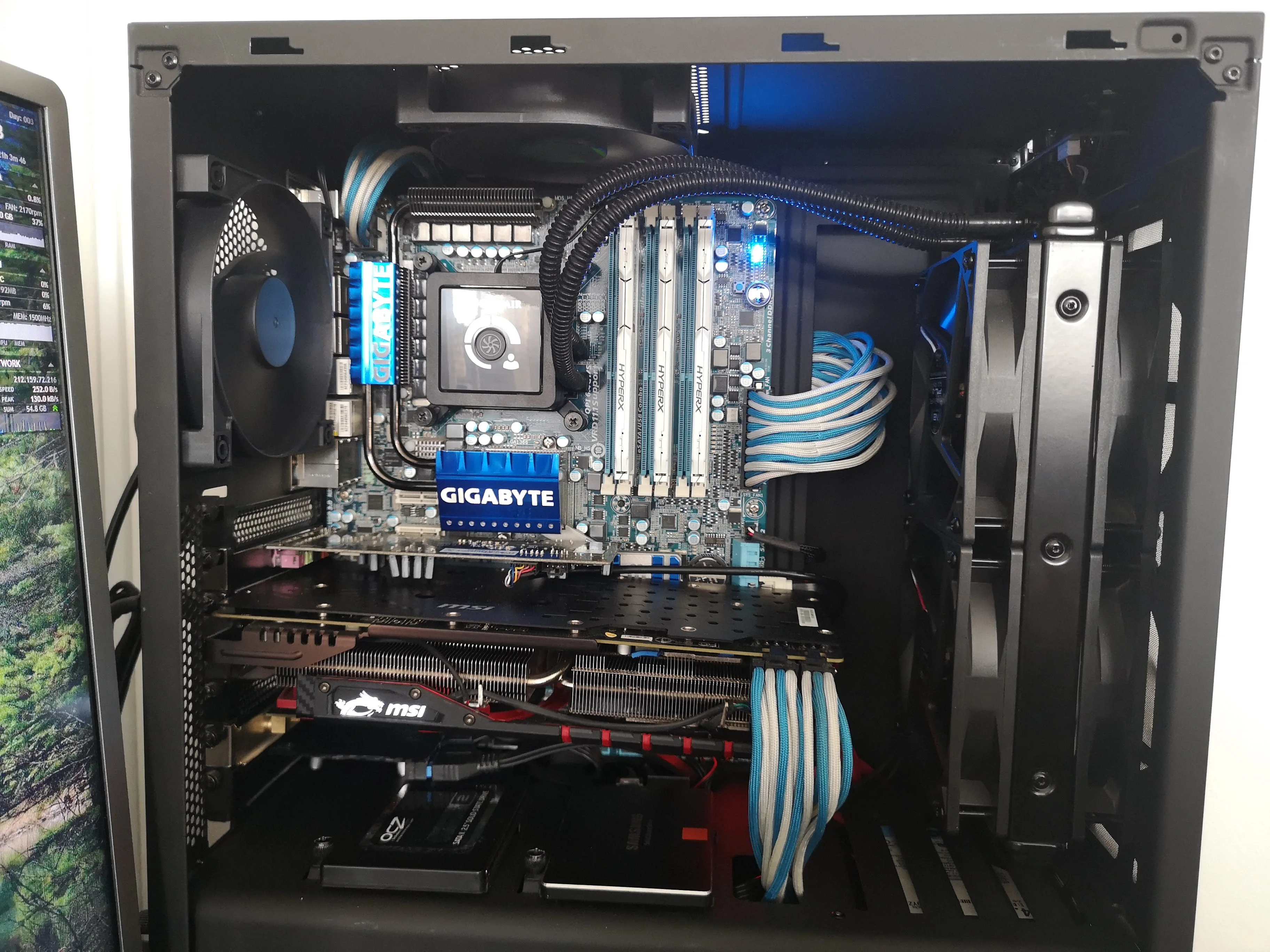

Thanks, I'll look at under-volting it and see what happens. Yes have afterburning running. In quiet mode, GPU fan off at idle, it sits at 60 with the case side off. In game it sits at around 80 with max fans with side off. Once side is back on it hits 94 the throttles.
With the side still off, while typing this reply I stuck the GPU fan to 100%. It's dropped and settled at 39. Not sure on ambient temp, but CPU is sitting at 26.

I know what you mean. I mainly bought this case for asethits and small footprint. It sits on small desk in the lounge.
CPU temps are pretty awesome, and the GPU has been OK when playing 1920x1080 @ 60hz.
All the issue started when I upgraded the monitor last week. The monitor is running 3440x1440 and overclocked to 90hz. I now have V-Sync switched off and use Freesync.

No, not tried any of that. I need as much power as possible so don't want to down clock it.
In that case your best solution is to buy another GPU. I disagree with others about needing to upgrade your case, it's not gonna make enough of a difference as yours is set-up quite well already. You have enough posts to use the member's market on this forum, I'd suggest keeping an eye out there, plenty of good deals to be had. eg 570s went for 80, I see a Nitro+ Vega 56 went for 180, etc.

So I'm experience problems of my GPU hitting thermal throttle. I'm not sure what to do next. The only way it'll run OK is with the side of the case off.
NZXT S340, H100 CPU cooler with 4x Noiseblocker PL-2 fans running full speed.
Standard NZXT exhaust fans, one rear, one top.
The Noiseblocker fans are 96m3/h which is 56cfm. I haven't seen many fans more powerful than that https://www.blacknoise.com/datas/downloads/datasheets/TData_BSP120_122012_de_en.pdf
I've either got to find another way to cool the old 390x, or increase air flow within the case.
I did think about finding a better case, but it needs to be small and full ATX.
Any suggestions please?
Has the card been always that hot or you got higher temps recently?
Undervolting and underclocking, with fans on in idle as well.
