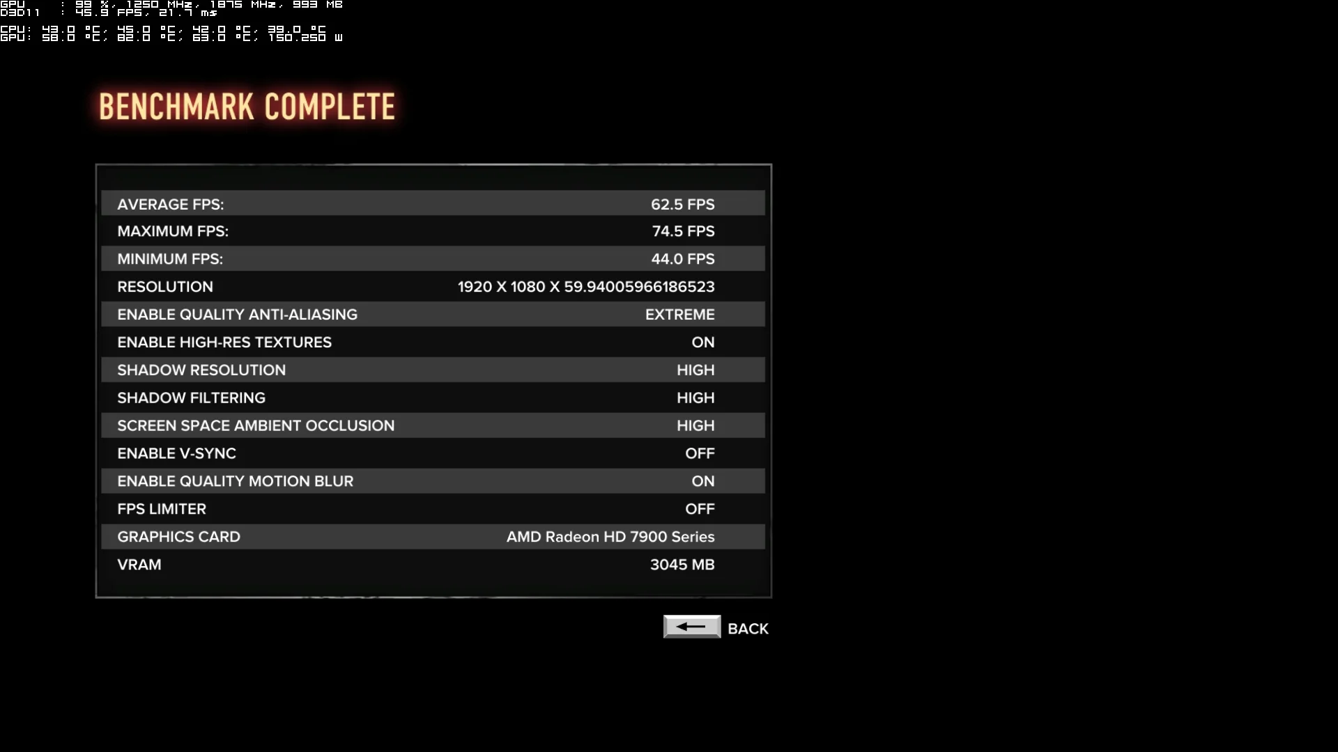

I haven't but seeing as you asked i just did a quick test. I only ran one game but will run a couple more later when i have time.
Sleeping Dogs - 1080p Extreme 1250 Core vs 1375 stock and 1875 OC'd.
I speculate the difference would be larger at a higher res (1440p+) although we might not see it as the pixel fill rate might hold it back somewhat.
See dont ask dont get - thanks for taking the time, seems to me (atleast for sleeping dogs) that the extra bump in mem. clock caused about a 10% increase in fps across the board ( 10% for average and max with 11% bump in min. fps) seems worth wile :)
