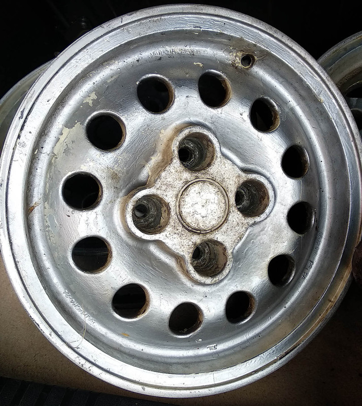

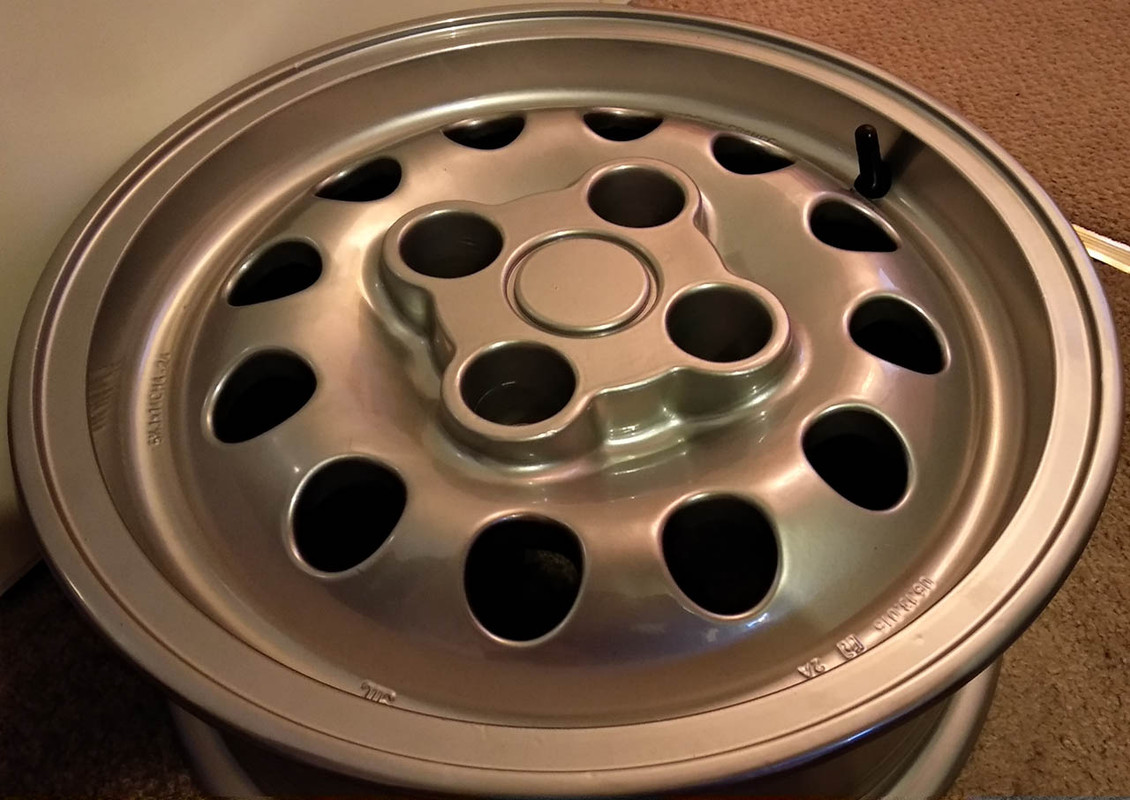

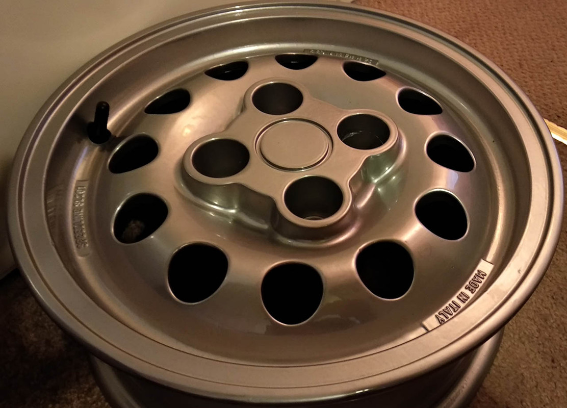

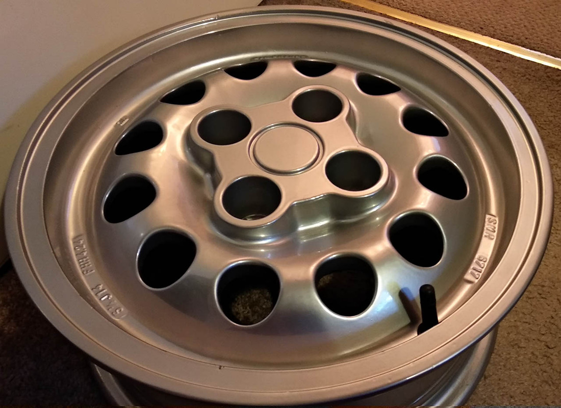

I had a set done by City Wheel Refurbishment (City Powder Coaters) a couple of weeks ago. 14" 205 GTI wheels which usually have a diamond cut centre, which I didn't bother with as they always corrode eventually.
The finish isn't perfect but is definitely passable - a couple of the bigger nicks/gouges are still there and there's the odd speck of dirt here and there. For £20 a wheel though, I am very pleased with the results. The wheels look immeasurably better than when I took then in.

They are by no means perfect. But the findings is decent and durable.
I like them because if you take alloys bare within 7days you get a fully coated set for £80.
That's the price you pay for a single perfect refurbishment normally!
Exactly, I dropped mine off on a Tuesday and had them back the following Monday.
You can see in my pics that wheel 1 is spot on, wheel 2 has a small speck on the rim, wheel 3 has a little bit of a fish eye effect here and there, and wheel 4 has a couple of nicks out of it - they don't claim to repair damage like this on the £20 deal though.
Looking at the state of them when I took them in I was very happy with the price I paid. That's "Flat Silver", they do some other colours on the standard £20 deal too.
