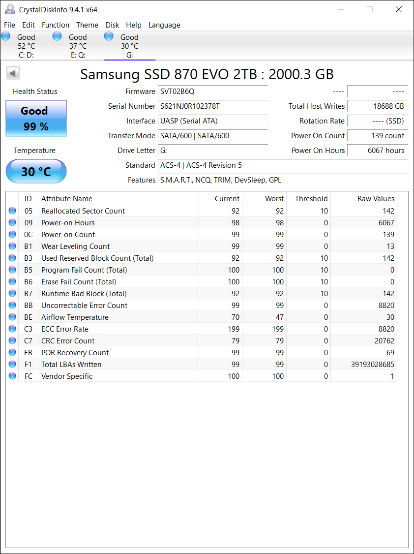

The 870 Evo issues show (in SMART) as bad blocks and reserved blocks being used, with high rates of ECC errors. Some of the first symptoms are taking a very long time to read certain files and a bunch of event viewer errors. They normally start showing bad symptoms around 10 TB of writes, so it is best to update them before that point.
My 2TB 870 was made in 2021-01 so is squarely in the affected range and the Crystal Disk Info shows the damage you describe perfectly. It's been stable since I updated the firmware but I don't use it....
