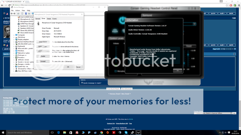

Hey all. So i asked for help with which driver to use for the headset itself within device manager and nobody replied... so i will incentivise things a bit!
first person to paste a screenshot of their driver info for the headset gets a product serial number to register within synapse to give them a free upgrade to razer surround pro.
thanks peeps
Is this what you're looking for?
But pretty sure this is what I use

Providing you have the Razer Surround software installed its pretty obvious which one you should be using as your default playback device. :D
(the top entry is the one listed after I uninstalled the crappy Corsair drivers and is the one Windows 10 selected to install - dont set this one as default but the one with the green circle/tick below)
Well I followed the above, only I didn't bother installing the crappy Corsair drivers, I can't get any sound at all from the headset. Installed the Razer software from the link, selected the above as default and I get nothing. Uninstalled the software and installed it again still nothing. Selected the corsair headset under Windows and voila, we have sound and it seems ok to me. Need to test some more but hey go figure. :rolleyes::D
