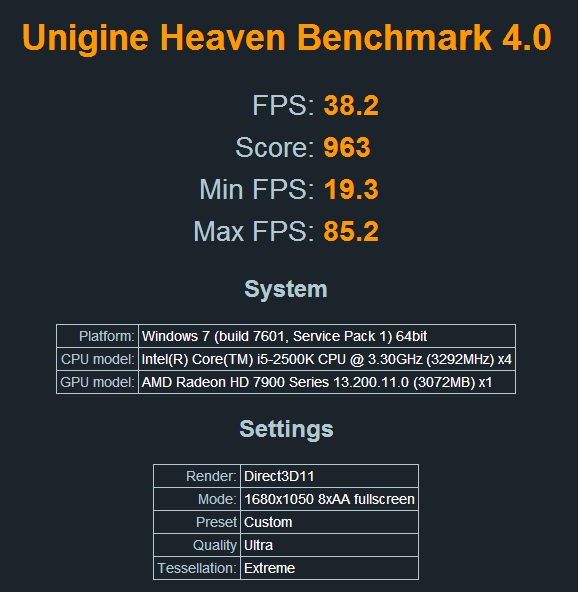

I installed my 7970 today and after playing Shogun 2 i was left rather disappointed. The campaign map would regularly drop the FPS to low teens for brief moments and in battles i still get epic slowdown (like ~10 fps) when selecting 10+ units and during fast forward.
I'm playing on Ultra settings and the slowdowns seem just as bad as did on my GTX460 on High settings. To see if someone is wrong i ran Valley and Heaven Benchmarks and the results are below.

Heaven Results

I have no idea if these results are good/bad/average.
My CPU is OC'd to 4.2ghz and my monitor is 1680x1050.
Thanks

OC'd to 4.4 now. I also failed to notice that my Extreme run on Heaven was in Windowed mode. Here's the proper results from 1680x1050.

Matt looking at the results goose has posted above, they do look a bit low and maybe should be about 10% higher could there be any setup problems.
I don't know Kaap, i can't see anything that sticks out. I think its likely a PEBKAC issue but those are always difficult to solve.
Is the card overclocked? Is the power limit at +20%?
