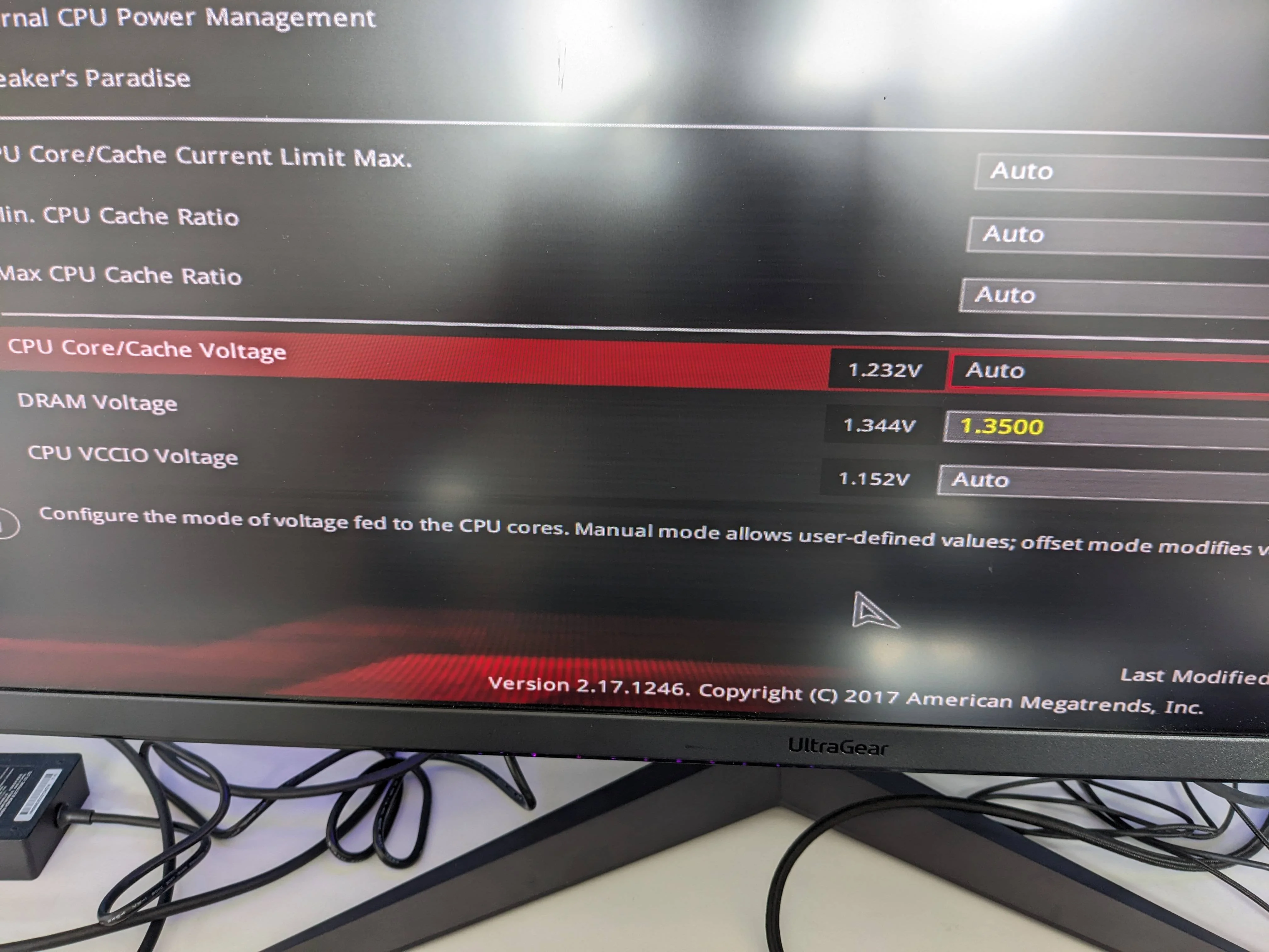

Ive noticed the past week my cpu and aio getting very hot. i have 6700k and its reaching early 80c when playing games. I put my hand ontop the case where the aio radiator is and it felt pretty hot. Cleaned the radiator and fans out with air compressor can and a brush and its not made any difference. When the cpu is not running anything its in the late 40's.
Some googling suggest that temps are a little high but not in the realms of throttling thats when it hits 85-90.
Any ideas on what i could do to improve the temps, is applying new TIM on it advised. Ive had this pc since 2018 and have been very naughty and never cleaned the radiator out until today.
Copied this from another site and they recommend doing this:
The first thing you need to do is change the CPU voltage type to Adaptive. The second thing you need to do is change the CPU voltage to 1.200v (that's the base voltage of your CPU). The Auto setting is over-volting your CPU a bit.
Never done anything like that before, is it worth ago?
