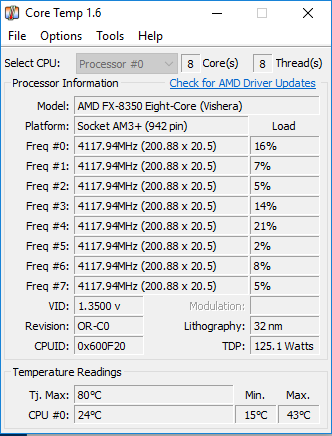

According to core temp, even though the cpu is at 15c, I can clearly hear the fan over my headphones.
Is there any reason for this?

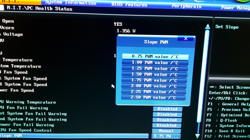

Take the cpu fan speed control off manual and set it to auto, it should then let you pick quiet / standard / speed settings.
I had only put it on manual after testing the 'silent mode' which is not silent at all. it runs at the same rpm.
