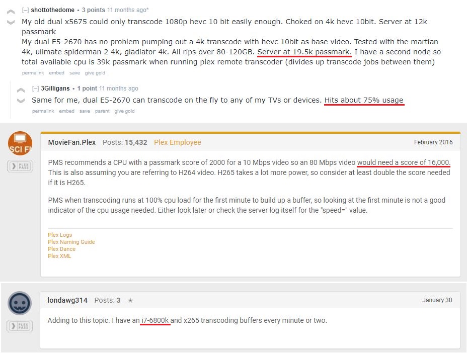

I have little experience in this field (as to Plex, video format, encoding, H265 etc). I've decided to do some search online, and it appears that four different people suggest that a Passmark score of around 15,000 is about to be the minimum requirement for transcoding 4k videos without stuttering.

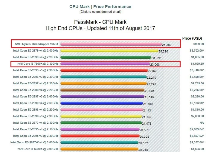

Checking the Passmark ladder (and estimating some unlisted CPUs by simple calculations with errors), I've found the following (relatively "affordable") CPUs to be on my list (assuming no overclocking):
CPU model: Passmark score, price, 4k transcoding capability for Plex Media Server
AMD Epyc 7601: 51,207 (est.), $3139 (not really affordable!), can transcode three 4k streams concurrently
Intel i9-7980XE: 32,618 (est.), $1999, can transcode two 4k streams concurrently
Intel i9-7960X: 31,224 (est.), $1699, can transcode two 4k streams concurrently
Intel i9-7940X: 30,248 (est.), $1399, can transcode two 4k streams concurrently
AMD ThreadRipper 1950X: 26,350, $999, can transcode one 4k stream
Intel i9-7920X: 24,255 (est.), $1189, can transcode one 4k stream
AMD ThreadRipper 1920X: 23,200 (est.), $799, can transcode one 4k stream
Intel i9-7900X: 23,068, $999, can transcode one 4k stream
Intel i7-7820X: 19,159, $600, can transcode one 4k stream
Intel i7-6900K: 17,980, $999, can transcode one 4k stream
AMD ThreadRipper 1900X: 17,211 (est.), $549, can transcode one 4k stream
AMD Ryzen 1800X: 15,419, $419, can transcode one 4k stream
AMD Ryzen 1700X: 14,663, $325, may stutter
Intel i7-8700K: 14,577 (est.), $350, may stutter
Intel i7-8700: 14,452 (est.), $312, may stutter
AMD Ryzen 1700: 13,816, $270, will stutter
It appears that the Ryzen 1800X is the minimum buy, and its 95W TDP is probably the coolest viable option. The price-performance ratios of the AMD CPUs do look more attractive. And an advantage of these AMD CPUs would be the unofficial support of ECC memory modules (yeah, without 3600C16 or 3200C14 there will be a performance hit).
