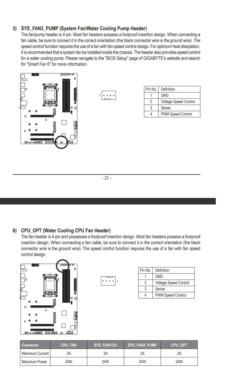

Can you follow the cable from the pump and see which header it it plugged into on the motherboard, normally there is an AIO pump header, failing that I would put it into the CPU OPT header.
Cpu_fan and sys fan1 both are both connected.
Cpu_opt is empty

They could just be fans plugged into those ports, can you follow the wire thats coming out of the pump and see where it goes.
The manual for your motherboard actually states to use CPU-OPT or SYS FAN 3 for the pump lol, guess they didnt read it
1 of the cables from the pump goes to sys_fan 1.
The other cable from the pump goes to a loose connector/splitter and then back to the 3 top case fans and not the aio fans.
The connection from cpu_fan goes to the aio grill.
