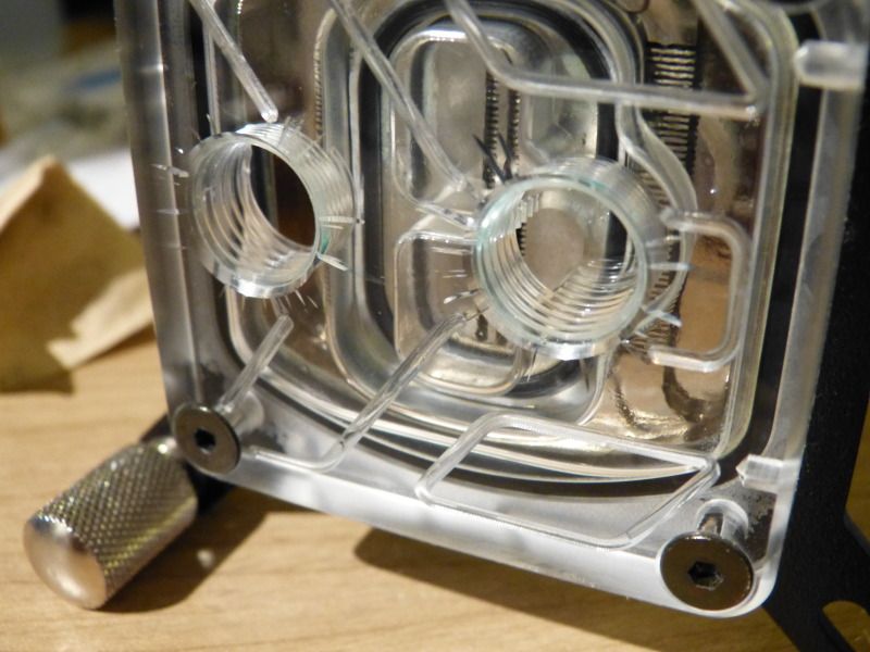

Hey guys,
Was in the process of changing all the tubing and flushing the system when I noticed small cracks on the block.
Anything I can do with this you reckon?? Cracks dont seem to have reached the top thread yet but its only a matter of time.
Anyone ever use PTFE tape on the threads?? Maybe that would make it worse, i dunno. Heres a picture anyway
Any ideas would be great
Buy a new one, not worth using it again and risk leaking coolant all over your expensive components, it's a no brainer.
PTFE would stop it leaking from the joints but if the cracks get worse it could leak from the top itself, did you over-tighten the fittings or something?
RMA it back to EK
and dont tighten your fittings up so tight next time.
personally, this is why I changed to Acetal blocks before i went back to aircooling.
Plexi top by any chance - I don't think EK will RMA it if it's been used.
But they do sell replacement tops (I wonder why...)
Plexi has no place in blocks imho - Acetal or all metal construction.
Cheers for the response guys, i guess i knew what you lot were gonna say, just false hope i guess.
Momo, ill take you up on your offer if its still open??? ill paypal you a few quid though
Just for the record guys, i bought the pc like this, took the block off and it was like that, gutted.
Cheerss Andy, ow do I do that? Can;t seem to find it in the 'user cp'
I clicked on the trust button under my post and click saved so not sure if that did anything
Had the same happen to me with the original EK supereme HF. I didn't even tighten the fittings too hard and it cracked. Haven't cracked the full nickel one yet.
