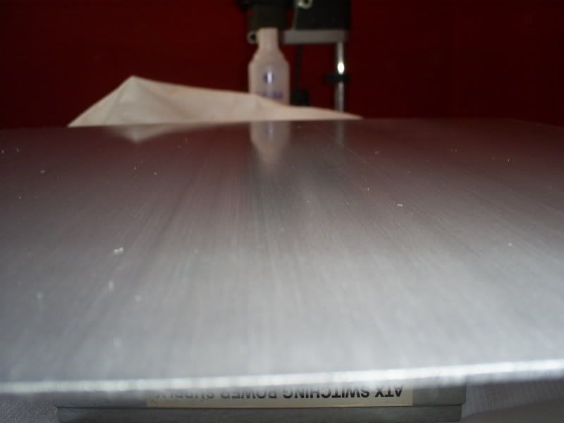

well todays work os done, this is what ive gotten through.
i got an early start by clear coating the panel hear is the stuff i founf, i got it from my local charlie brown's for £5 a tin looks nice on as well.
heres a quick shot of the aluminum after its been clear coated sorry there are not more/better pictures the memory card was full and before i remembered to snap some more shots id taped them up ready for marking.
The clear coat seems to give the brushed effect a more unified look and it seems to work as a mild concealer as well, it makes the metal a lot more forgiving to inconsistency's.
