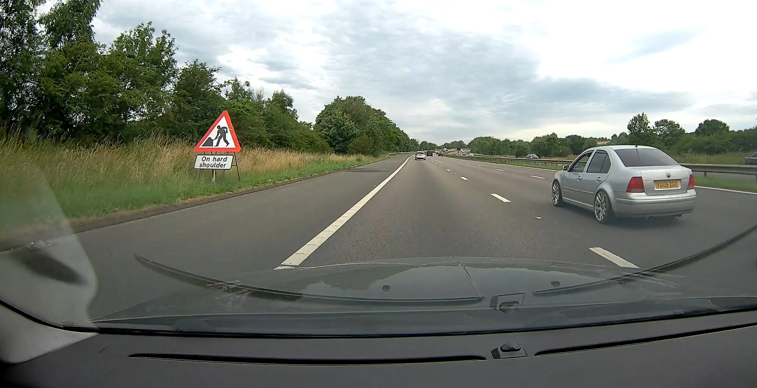

I swapped an A129 with the 4k pro version, it's much much better - I could barely pick up plates with the old one, in daylight the pro is perfect. Night performance isn't great but mainly because I've fitted the CPL over it.
You'll need to open both in full res to appreciate the difference.
A129 Pro 4k
https://i.~ibb.co~/92fWPkC/A129-PRO.jpg
A129
https://i.~ibb.co~/yYzR6JR/A129.jpg

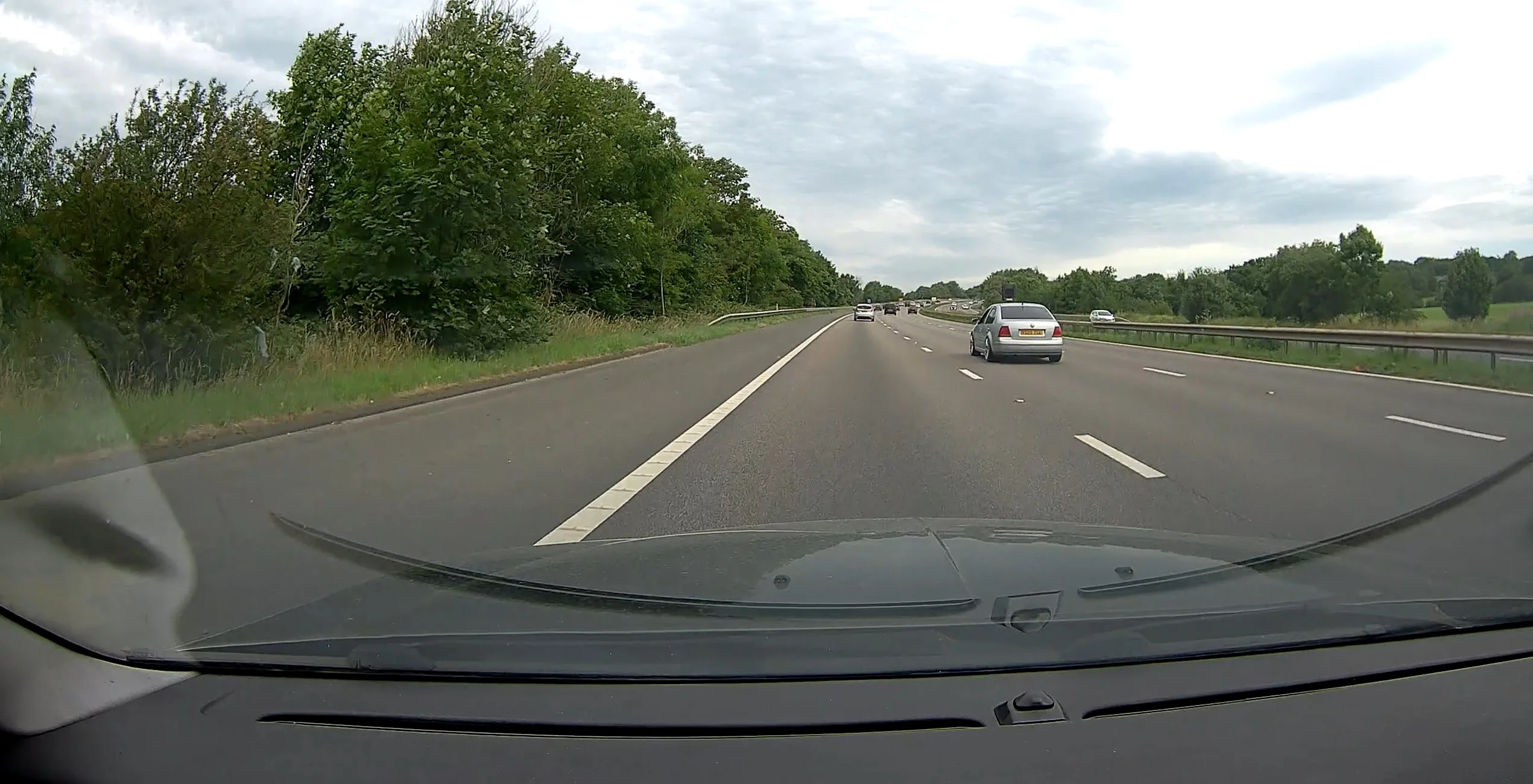

A129 Pro Duo here, for about a year and a half. I've been largely happy with it. Have come out to find it had crashed and frozen at some point over night a few times (no idea why, running v2.9 FW) but other than that I've had no complaints.
A129 Plus in comparison..... I know the lighting is better in my pics so it's not a truly fair test

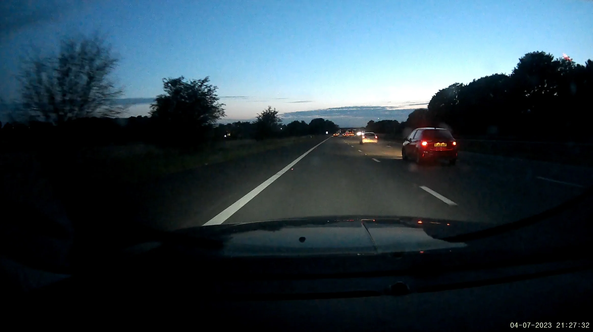

And a shot at dusk on an unlit motorway
Not terrible, probably a minimum as to where you want to be looking at for a dashcam. Anything 1440P/60fps and above.
(Sorry for massive pics, I thought the forum would resize them)
