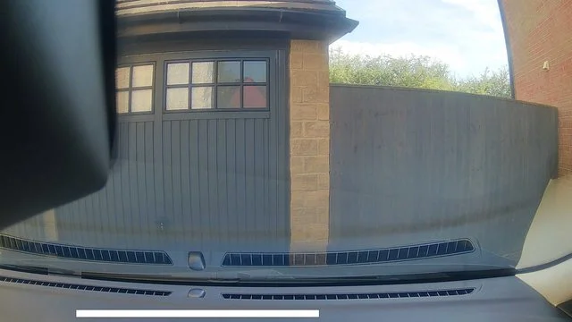

Just bought a viofo VS1 but am struggling to find a location to fit it. My car has a massive central housing covering the rain sensor/cameras (ironically).
I can't fit it to the left of the rear view mirror due to the power socket being on the right, which would be blocked by the housing, and it covers the auto dimming rear view mirror.
Only place is tight up behind the mirror on the drivers side, but a good portion of the view to the left is blocked.
Is it even worth it? If not I might just return it.
The image quality is poor at the moment as I still have the plastic cover on it.
This is as high up the windscreen as it can go, any higher and the rear view mirror blocks it being mounted. It is so tight against the mirror in fact that it is touching the button on the back so funnily enough all I need to to do lock the video is gently pull the camera towards me, which presses the button against the back of the mirror.
It should be possible to lower the camera slight and twist the camera to point the lens down more. It is not important that you see sky as much as you see enough to determine responsibility.
Cheers, I did end up lowering if ever so slightly, but too much was sticking out under the drivers side of the rear view mirror so will just see how it goes where it is :) At least it looks discreet and hard to see from the outside.

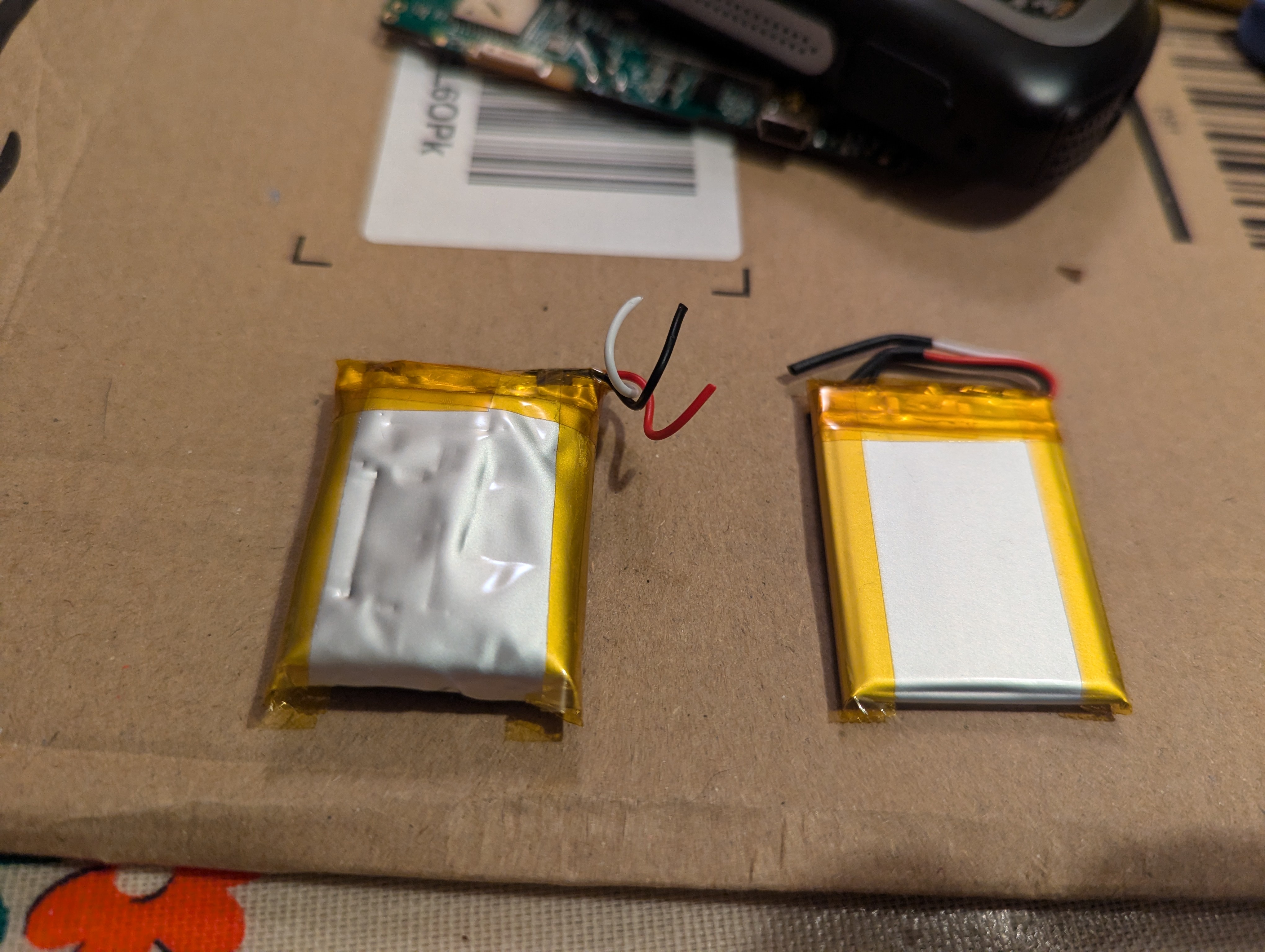

My 5 year old Nextbase 522GW is no longer starting recording when I turn the car on - it works if it is powered on, disconnected, and powered on again straight away, and I can turn it on manually - but guarantee I will forget to do so on the one occasion I really need the footage!
Replaced the SD card with a new one, still the same issue - and it occurs whether it has a card in or not anyway.
Talking to Nextbase now, but suspect it will need replacing, so looks like I need a new camera - front & rear.

Well... kudos to Nextbase where it's due, they're sending me out a Nextbase branded 32GB MicroSD card to test with and confirm it's definitely not the card causing the issue.
I'm fairly confident it's not going to make a difference, but you never know, and it's certainly good customer service for a 5 year old product which is way out of warranty, when they would have been entirely justified in politely just fobbing me off :)
SD Card made no difference :(
However they said I can keep it anyway as a gesture of goodwill :)
Some more investigation, and I think I found the culprit:
New battery on the right, old one on the left... not sure it's supposed to look like that! :eek:
It also seems to be holding charge now, which it wasn't before - haven't tested it in the car yet as only just got a chance to replace it.
