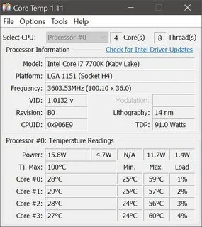

I've been very happy with this 7700k with temp variance across the cores at idle and load. This is non delided with all cores synced at 4.5ghz cooled by a Noctua D14. So far up and running for 48hrs and a few hours gaming in Destiny 2.
Seems they did a very good pasting job on this one.
