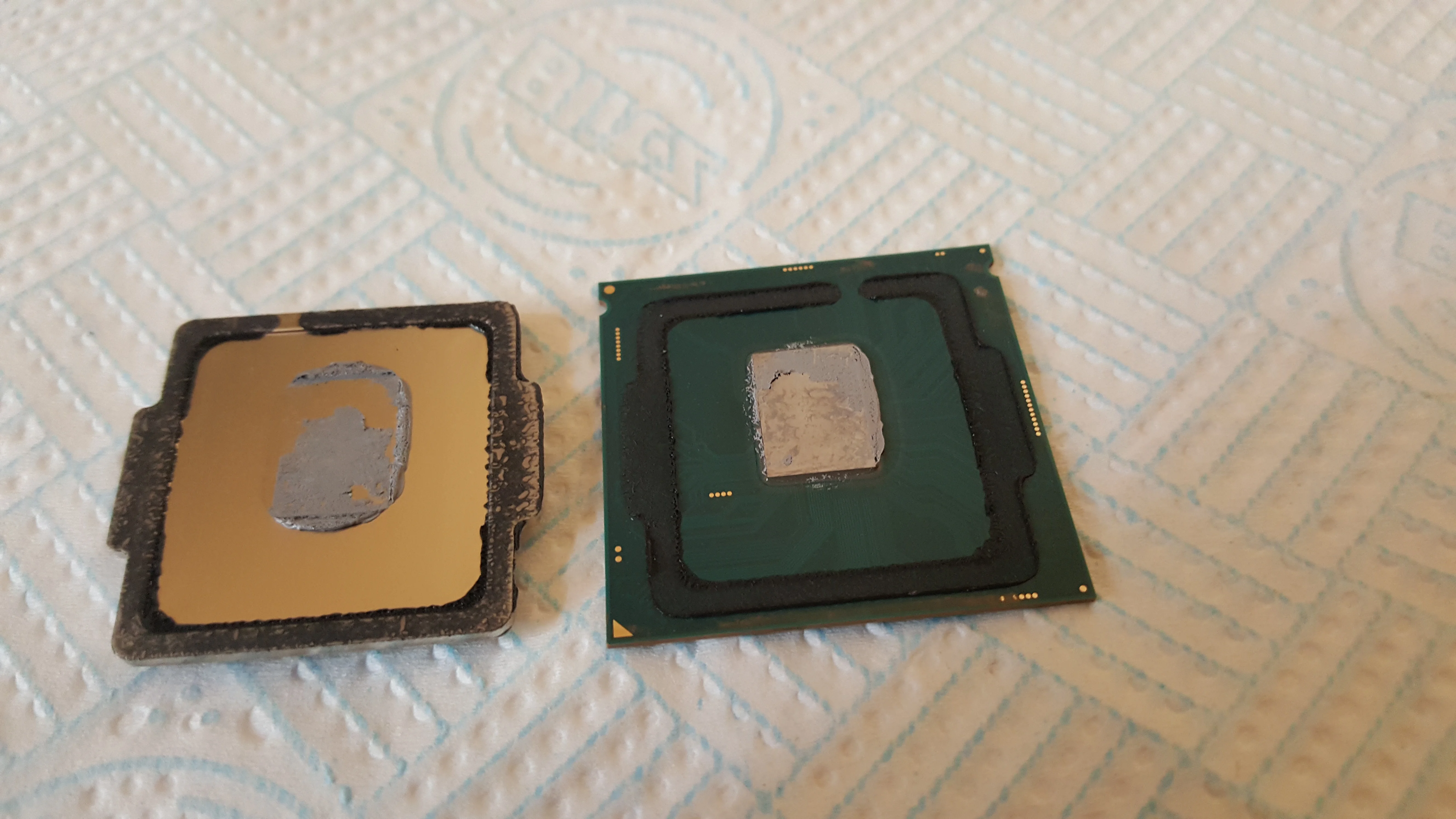

Christ, well that was interesting. The actual delid itself was easy but led to other shenanigans.
Anyway, reinstalled the cpu and powered on, board goes on and off in a loop, end up taking the cpu out and notice a fractionally misaligned pin on the mobo socket. Ended up using my phone camera to zoom in on it and poke it back into place with a pair of tweezers. Before that though i had a stuck sata cable...or what i thought was stuck. Ended up yanking out the actual connector from its pins on the board as i forgot it was a locking cable. Ended up sorting that out as well with the tweezers to line the pins up and it clicked back into place. :rolleyes:

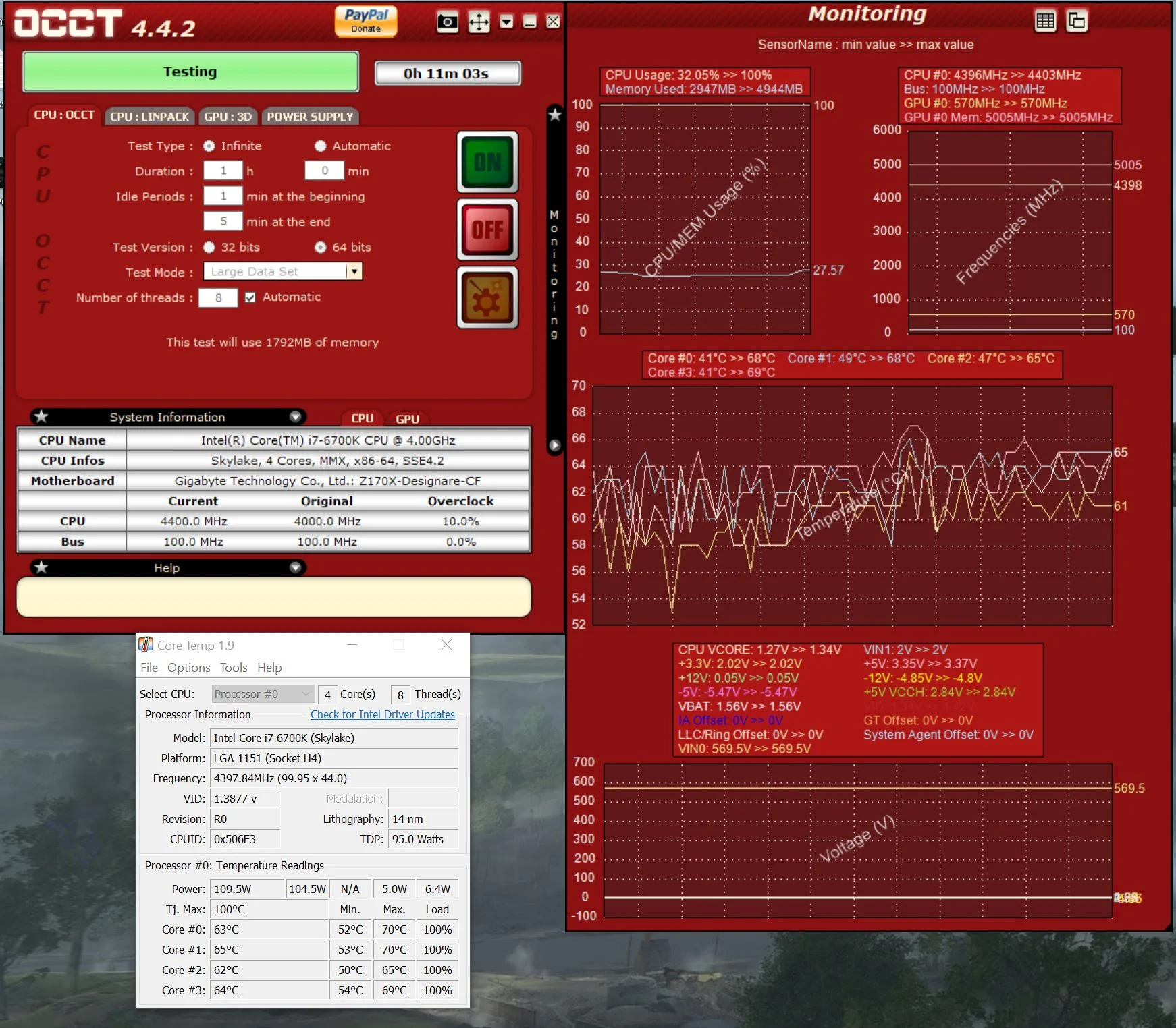

Anyway temps wise it seems to be topping out around 60ish at stock speeds, going to try clocking it up a bit and see what happens.
Sounds like you've been having fun :p. The 2nd image - initially i wasn't sure what i was looking at, that liquid metal stuff looks mental. So how big an improvement over default paste?
Well im running occt now at 4.4ghz maxing at 68c at close to 1.4 volts, would usually be into the 80's by now. My chip isn't the greatest clocker.
12+ degree improvement is decent. Heard some folks get as low as 5. Have fun OC'ing! :)
