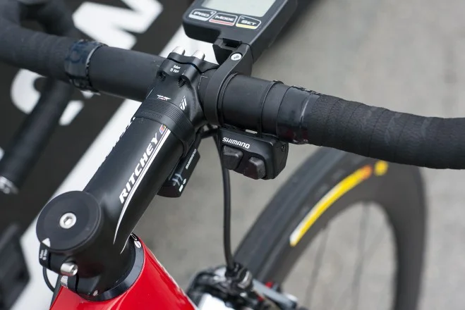

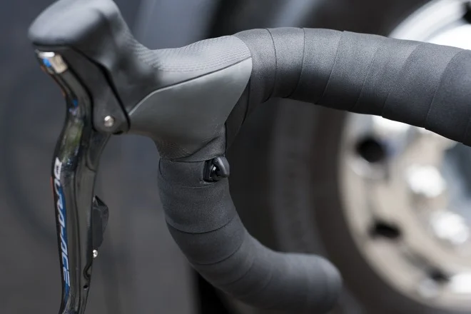

Anyone with Di2 got thoughts on Satellite (Climbing) and Sprinting shifters?
Don't forget you'll need to increase your junction boxes to 5 port with these, can't really see the use of them unless racing tbh. Number of times I'd use climbing would be minimal and the sprints are just a luxury and barely require any movement to shift when you're on the drops with normal levers anyway.
Aye I'm not sure about the sprint shifters, the satellites though I definitely want.

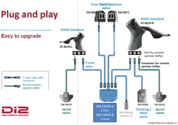

3 port is simply batter + front/rear derailleurs, right?
Yes that is correct. I assume they must piggy back when doing their Paris Roubaix style stuff, as I've only ever seen 5 port.
If you want internal battery you have to go for a 5-port anyway so not an upgrade for a lot of people.
I'll be looking at sprint shifters shortly I think. Useful for changes in the drops, which sometimes needs to be done if out of the saddle sprinting up a climb or some such. Depending on hand position can be bit of a stretch to get to the normal upshift button.

Well the battery on the Canyon is internal by all accounts so would be a 5 port? Incidentally why does internal require 5 port?
Yeh should be. Requires a 5-port because thats how you charge the internal battery. USB lead from PC to a small box, that then plugs into the 5-port junction box.
You don't need a 5 port EW90 for an internal battery.
If you upgrade from external battery to internal then you need the 3 port EW90 box as that is were the charging port is located, it's seperate from the 3 ports for the actual components.
6870/9070 shifters have 3 ports on them, one for the wire connecting it to the EW90 box, bottom hole for the sprint shifter and the middle one for the climbing switch.
So the add on switches connect to the shifter and then there is a wire from the shifter to the junction box.
So the 3 port box is left shifter(+addition switches), right shifter(+addition switches) and the 3rd port is the wire that enters the frame and heads down to the internal 4 port junction box. This wire, battery, rear mech and front mech fills the 4 ports.
The only reason to get the 5 port EW90 is for the time train extensions as they add another wire each to the front of the bike which can't go into the shifter. It makes it easy for clip on aero bars with DI2 satelite as you just clip the bars on, plug them in and you're good to go. You may need to check all the firmware is all up to date the first time round but after that should be plug and play.
Thanks for the clarification Jonny!
