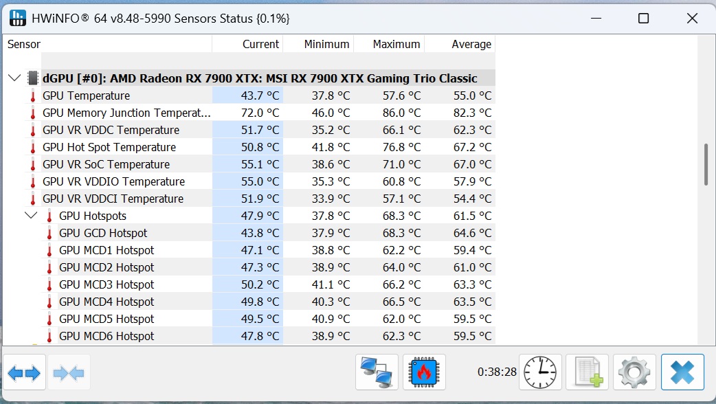

Do these GPU temps look ok while gaming?
Well I lowered the Power Limit % in the Adrenalin software by -10% and now have these temps...
Started using HWiNFO as it shows the hotspot temps, couldn't notice any difference in frame rates and its a bit cooler.
