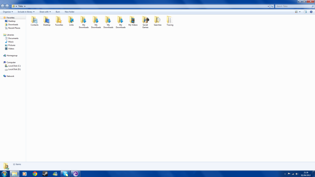

So firstly I did the Downloads folder, properties, move, then selected my D: drive and made a new folder and moved it. I then moved all the other folders there too. However when I checked on my D: drive the folder I made (named User files) was not there... Just the "My downloads" folder :confused:
I went into my libraries to view all the folders such as Downloads, Favourites, Music etc. and all the folders I moved are not there, well they are, but they are all named "My downloads" and all have exactly the same files in! :eek: :confused:

Nice screenshot for you all :p
change to details view, right click the column headers>more... and add a path column
now you can see where they're all pointing to. edit the properties if you need to.

I think this is what happened, is there any way to fix it? :confused:
I tried editing their paths in the properties menu but it won't let me move them :(
