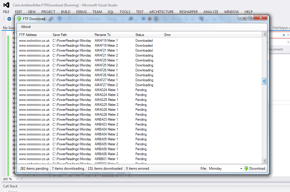

Launch it, select your file (bottom-right) then hit 'Download' (bottom right) and see what happens :D.

I've been testing it this mornign and its amazing. It takes 60 seconds to do a task which took 60 minutes. However, there is one issue. It manages to download nearly all 444 items except about 9. Which say "The Remote server returned an error: (421) service not available, closing control connection". checking this IP manually shows no errors.
It's always the same 9. It's the last 8 in the list and one a few before. But as I said, manually going to this ftp in IE shows no issues. I've tried the download process 5 times and it produces the error every time. And always on the same IP's.
Apart from this, it works beautifully. Any ideas?
Update:
If I remove all the ip's from the CSV which download OK, then the programme will download about 7 of the ones it previously couldn't. however, there is still one IP which it refused to download even though I can download it myself through IE. An Odd one.
Update 2:
solved the issue. There was a couple of duplicate IP's in my list. Re-arranged the CSV and now it completes with no errors. Fantastic work.

I imagine the servers for those duplicate FTP connections only allow one login per IP/user at once so when the downloader spawned multiple threads and connected to it twice at the same time they didn't like it.

I love how it looks now, with IP, rename to and status. I don't need save path shown. Would it also be possible to change "Rename To" to read "Reference".
