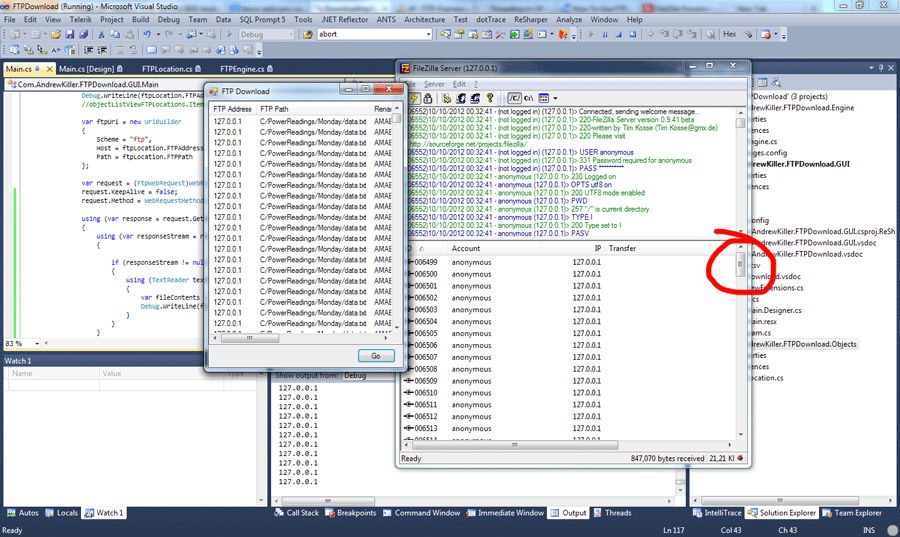

So I got bored and wrote a little test program to see if it's possible. 500 simultaneous FTP connection threads back to localhost reading a small txt file (which will be miles, miles quicker than real-world stuff though and mostly thanks to FileZilla Server being super speedy) finished in under a second :o.
Might try and finish it off tomorrow if I get time :D.
