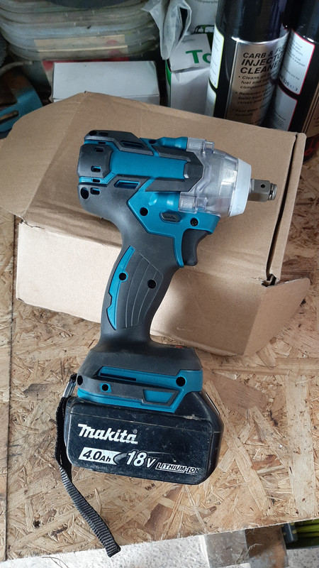

Got mine, its crap, won't even undo the Abarth 17mm wheel nuts, can't budge them, yet with a breaker bar they undo easy, so I just tightened them up but lightly and it cannot even remove those. It tries very hard, thrashing away and dust/rust vapors appearing but it just does not have the torque to spin the nuts off.
I'd say this impact driver is about 100-150nm maximum, I shall do more testing shortly of loosening a bolt and then torquing it until we get to the point of it failing.
Battery is a brand new 6AH Makita 18v, so not battery and had 100% charge.
AVOID!
P.S. Max nm it can remove is 150nm, just over 100lb/ft and this is on a bolt that has being undone, re-tightened so there is no corrosion etc. It tightens to around 120nm.
In short it does not even come close to the advertise 520nm, as the saying goes you get what you pay for.
Can you post some close up pics please? Interested in how well it's made.
It's not bad to be fair, not much weight to it as a bare unit so it's not too heavy with a socket and battery.
The battery is a little tight to get on properly so I'd guess it needs some smoothing around that area to make it go on easier.
Mine seems to work better than Gibbos though, got a Clarke air impact gun that's rated to 680Nm and if I do a nut up with that, the battery one will undo it in a couple of seconds.
If I tighten a nut up with the battery one, the the air one will tighten it a further 1/8th of a turn.
I don't have my big torque wrench here but I'll try it out in the week and see if I can get a rough figure it'll tighten to.

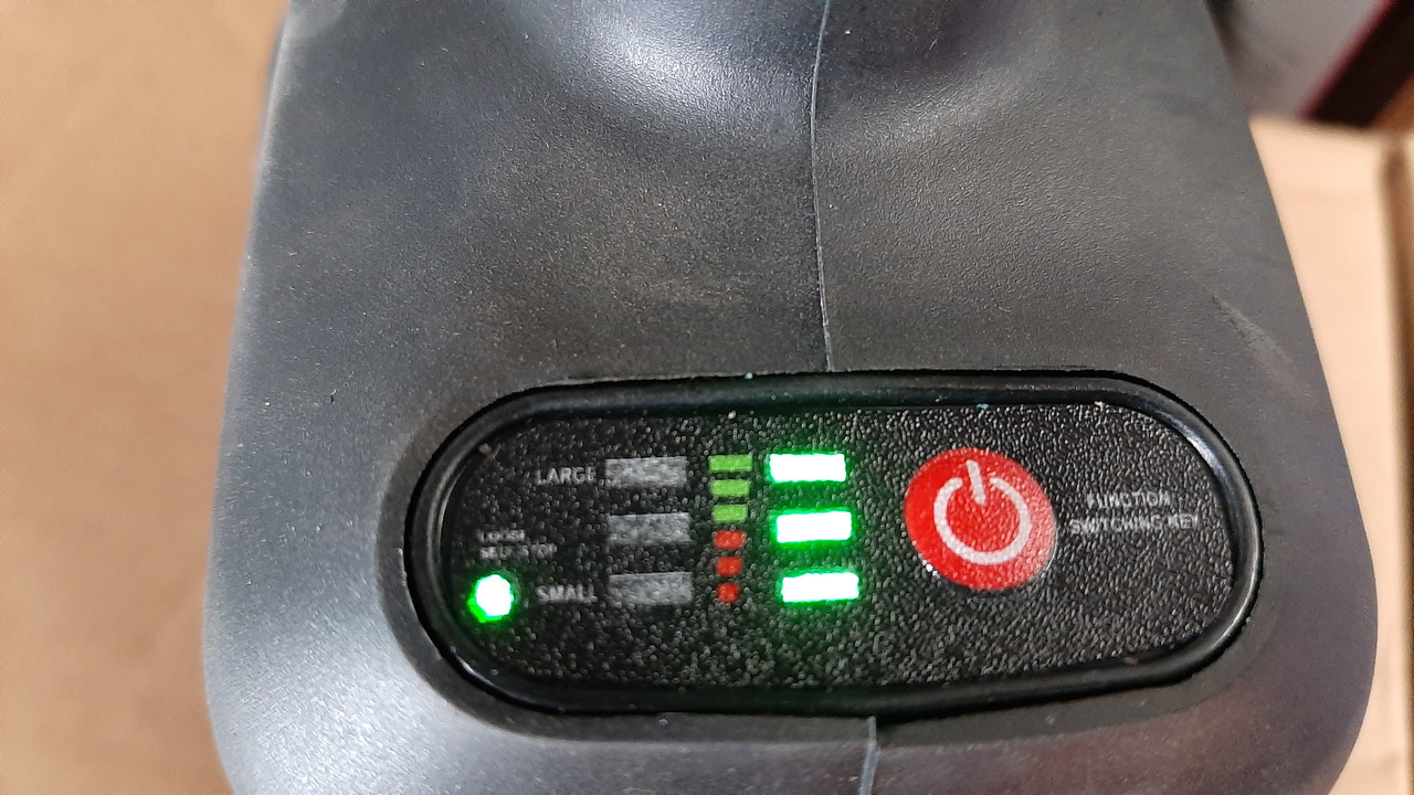

Couple of functions on it as well, can select between small and large nuts and also a self stop when undoing. Both work fine.
@Gibbo might be worth checking you've got it set to large.
For reference, my batteries are 4Ah 18v, about 3 years old and they get used most days.
The small to large setting is only optional for tightening up.
One step is just for undoing.
I did try all three settings and for whatever reason the 17mm wheel bolts on the Abarth when torqued beyond 150nm are beyond this impact gun and if tightened by with a bar by hand it has no chance. So on a suspension bolt I can’t see it having any chance. Unless it dislikes my battery which is an 18v 6ah 100Wh and like yours battery is a tight fit.
