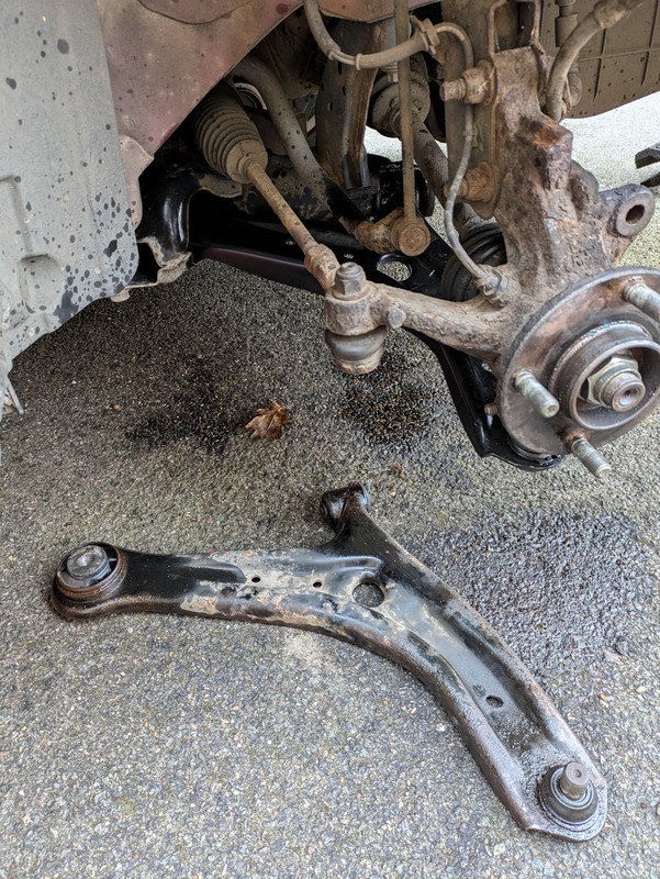

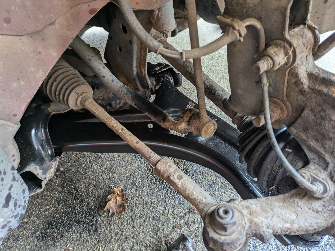

The suspension arm was a right ****, it was pretty difficult to get it off and out, to be honest it took some wiggling to get the new one in.
I'm glad a had a lot of tools, pry bar, hammer etc all got used and a lot of elbow grease, it wasn't easy.
I took the disc off because it made access easier, and noticed the pads were pretty low so as I was half way there anyway ended up doing the brakes as well.
