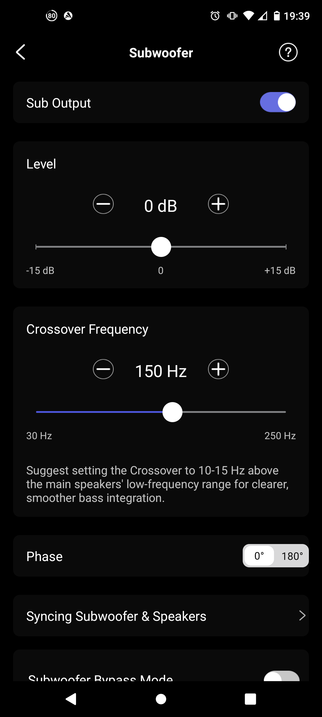

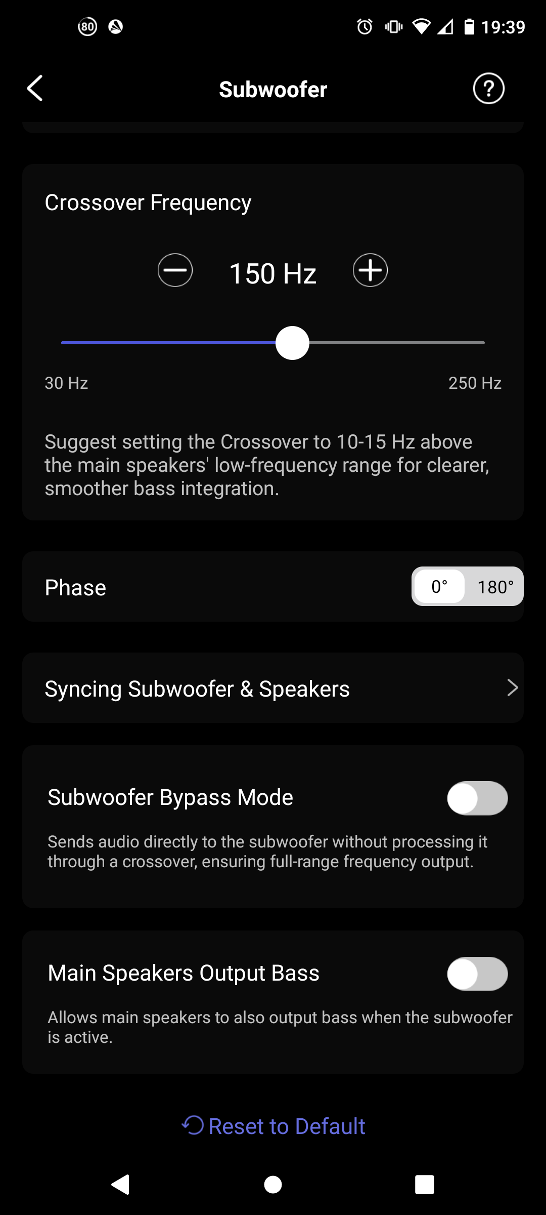

will you be able to high pass the speakers? Does that amp have bass management or does it cross speakers at 80hz, with low pass for the sub at 80hz?
Things like Wiim amp have bass management (or a AVR)
Not entirely sure, the amp just has a sub RCA pre-out.
That said the sub amp has a high frequency crossover cut off dial, if that's the correct phrase.
I think from memory I can set the on board subwoofer filter to about 150hz max high end cut off but obviously you'd never leave it that high and dial it down to a frequency where the bass on the stereo pair starts to drop off.
I can't remember what I've set the sub to, but I suspect I've naturally set it sub 100 hz, quite possibly round 80 hz but I'd have to pull the sub out to check the dials on the back.
