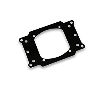

Hi can anyone confirm for me that the Mounting plate for the EK Supremacy AM4 bracket will fit the v2 square EK Supreme hf?
Saw this in a old thread and mine is the square top cooler in the pic I was thinking of getting one of the new AMD CPU's but if I need to buy a new block I may as well go Intel as I wouldn't be saving anything.
You can for the square Supreme HF as it's compatible with the Supremacy brackets, but I don't think you can for the original Supreme though as it was a different shape IIRC?
Basically if ti looks like this then yes:
If it looks like this then probably not:
is this the plate I need if it does fit ?
https://www.overclockers.co.uk/ek-water-blocks-amd-socket-bracket-for-am4-wc-9dx-ek.html
ty
You can't actually tell just by looking at the blocks as it turned out there was some crossover.
Basically if your current brackets have a centre like this:
Then the block will not be compatible with the new brackets.
If they have a centre like the one you linked then they will.

Thanks for the reply and I can tell that mine is like the pic you posted balls :( might just a get the 9900k or I could just go on air but then how would a live with myself
I take it the picture you posted was a bracket that is no longer made/sold but I found this somewhere.
Mounting plate Supreme HF AMD - Nickel Model: EK-HF-AMD-PLATE-D
AF1QipMLK2S1LlHAX5dTkKCNWqNHQ4umq1m-SiyFWqNU
Qb9g3S6tyOAzZg7-eNtM8kajskjEbIUWez4ZitmxDZbSrcoxF04ZyOvJ-_8QIBE_lKMjSHjwHkEfAwZ2Quoc7r2w0lrQ6Iydf0gvDKuYT4zt4BFcmD_R7bL3BPNogo3VAAdBPDju8ZGeacbUIXrN3Zof9KPpbdmHu3bNj5X9iKFZLtfN5bqN-L31S8KffoYP7OlqE_4GCpP8tb8ZgeV48d7o7b1lC4C2Zg2jBeZaMa5lx9OvBT_AxMsKUSpRu7SJS4TMRiGpQNth4RWEyyShg9U-PVCv7UGxob8fflMgKHyNtRFcfcaOACry0e_cedsMWugrkqLYVBsC7cm5IntRFRVGlBbtQNdDgfDDm6RWQAxZMEWKUIdJsKCS9b6gbrTmNVh7EoP-nytWgw-0iAyXEtPg4t6HhkVGwDP5ZnKAh7r4JdevWuc50w-U8FTeNTVkINIxTf9zX61qeVPtgWre8Qw05hN3JVA18HJj-gl32OCHAnLvSfazhA3ZUO7SYZ_Ttkl6jDRRlO8uo6JphpsZ7VAp8YdUFFPtn5Odf_5_UTsUrxHkq6Cxw49F6fUjYQNqWtFEIZTgWzyLlGZiFB3ph3f8tIH28AiAws1LytzRx1vfpVZECg0eHhYQYm9L0VO-FQATANoeJE9smyo0bA_zt1ZqFQvcTQ=w574-h408-no
would this not be the bracket I need ?
