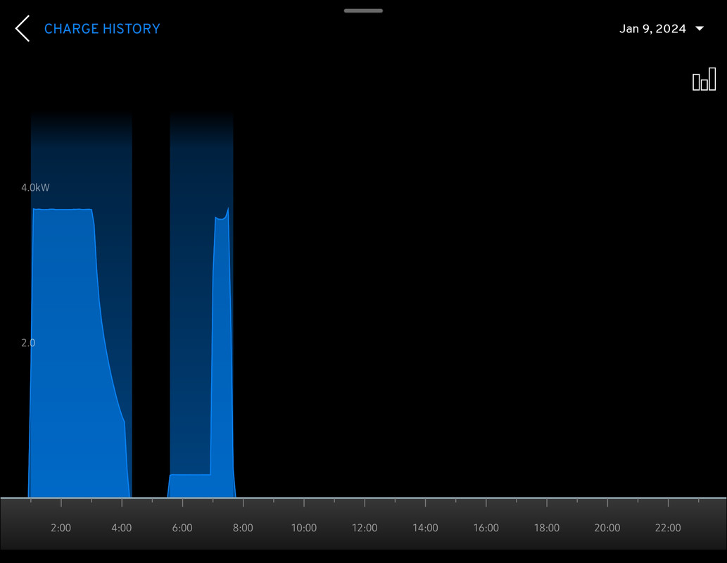

I can sort of understand what he means, I only have 14,9KW usable battery and heating the cabin takes ~3kw on mine which you can see on the Zappi, What I noticed is that my range with lots of short trips where the car has been left to cool gets quite an impact from having to reheat (you can watch the miles drop stationary when its warming up) versus what they do in test and have a long run and go oh heat pump makes bugger all difference, as I too get more range on a steady run where the interior heat is maintained, reckon a heatpump probably be more useful in this scenario as when our heater broke, we got another ~7 miles in similar driving, which when you only have on average 30ish miles is a nice bump, when you have a larger battery you EV usage ve heater is less of an impact in miles you can get overall as you have far more energy stored to play with
