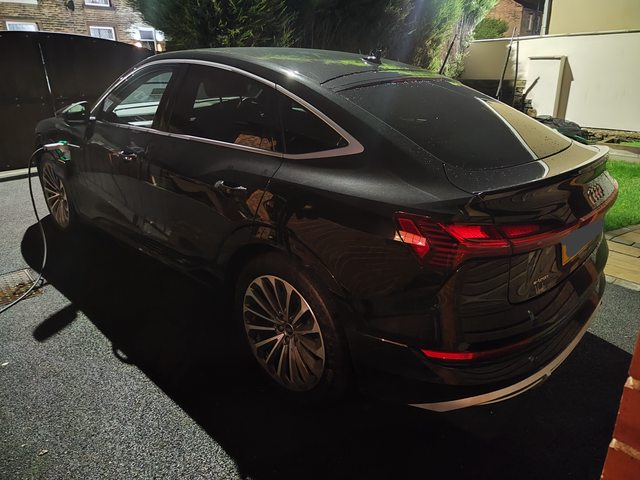

After months of looking into this whole EV thing, I picked this up yesterday.
