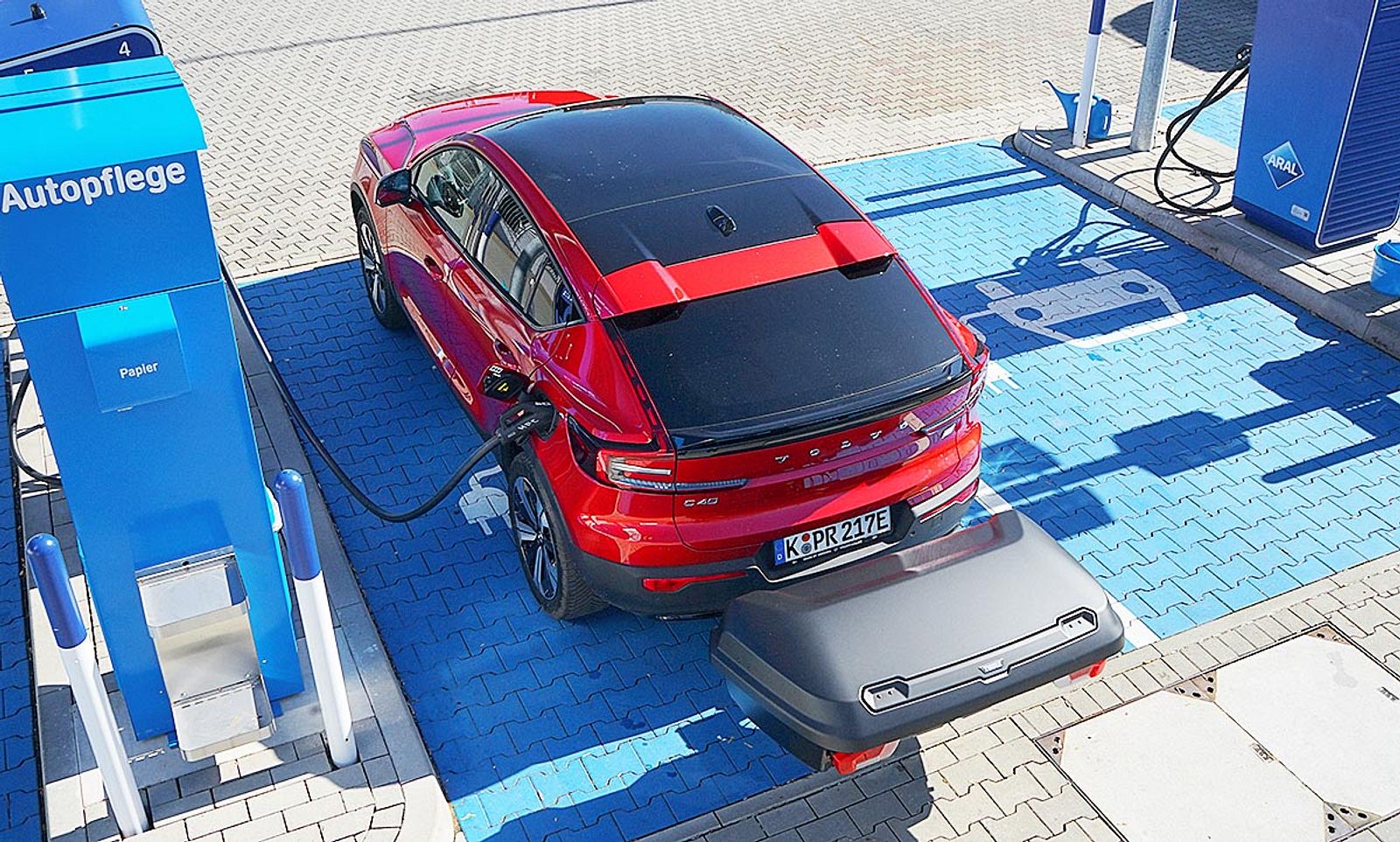

What? lolI read data that suggests putting the roof box on backwards actually gets you better range, which seems counter intuitive.
You are better off with a rear box, than a roof box, on an EV.
That makes absolutely no sense, I will look into it.
Results of the practical test (table)
Test vehicle:
Volvo C40 Recharge
Pure Electricwithout
payloadBoot capacity -
payloadRoof box
payloadRear box
payloadload weight 0 kg 50 kg 50 kg 50 kg Fuel consumption in km 111 km 111 km 111 km 111 km Energy consumption
(recharged)21.3 kWh 22.4 kWh 26.8 kWh 22.0 kWh Fuel consumption per 100 km 19.2 kWh 20.2 kWh 24.1 kWh 19.9 kWh Range with 67 kWh
battery capacity (net)345 km 332 km 278 km 337 km Loss with a 67 kWh
battery capacity (net)- 13 km 67 km 8 kilometers
Has anyone been using roof boxes on their EV, curious as to what kind of mileage loss you had while doing long trips.Obviously you'd just charge it more frequently but our diesel looses about 7-8mpg.
I assumed as much but didn't know if there was a greater impact. Just have to do what we normally do lol.Used one on my Polestar and the EQC - it will effect it, but it also means that I’m carrying a load of weight too so I just accept I’ll be taking a large efficiency loss and plan accordingly. Any long trip will need public charging regardless so I just find the fastest charger I can and ignore the price because it’s so cheap to run 99% of the time!
If you want to save some range, slow down a bit and that’ll help offset the extra drag.

What sort of real world mileage per charge did you get from your polestar?Used one on my Polestar and the EQC - it will effect it, but it also means that I’m carrying a load of weight too so I just accept I’ll be taking a large efficiency loss and plan accordingly. Any long trip will need public charging regardless so I just find the fastest charger I can and ignore the price because it’s so cheap to run 99% of the time!
