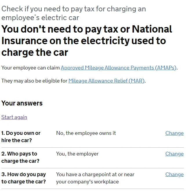

Work place charging BIK is mentioned in a recent Fully Charged Video
In terms of tax requirements - It's no different to having a free fuel pump at your workplace.
It isn’t because the government exempted it has an incentive to adopt. There is a checker here:
https://www.gov.uk/expenses-and-benefits-electric-company-cars
If the charger is on company property or nearby and is free for employees, there is no BIk.

I already checked that link, see the outcome below.
Oh it's because you own it, the business sorts mine and thus my outcome is I'm totally fine.
Your not answering Q3 correctly for what we are discussing. Your answer implies the company gives the employee a prepaid card or use a company account or something to pay for 3rd party charging for personal use.
The other answer covers where the charger is in the company premises (or nearby) and employees can use or free of charge e.g. while at work. The company just absorbs the electric into their wider bill.

Thats how i read that website? Seems not to be taxable?
doesn't your answer imply money is being payed at the chargepoint eg. it is not owned by the employer, and money is being given by the employer to pay for the electricity. ?
seems bady worded anyway

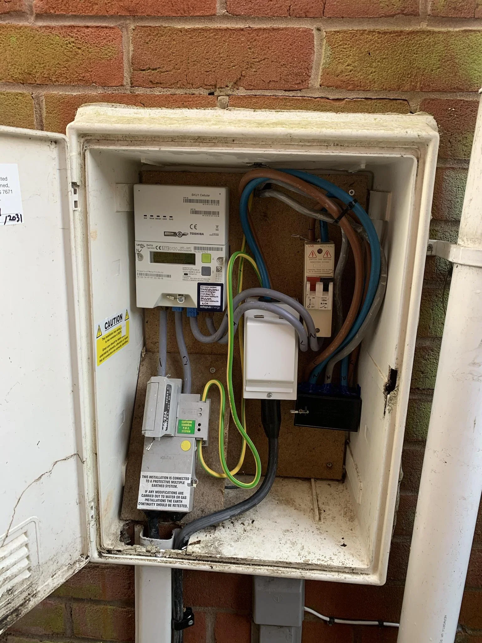

How are these fitted? On the wall it will be fitted on is the white electric meter box and of course meter and inside the house on that wall is the RCD box. Will they just route from the external meter? Should be a simple install i think anyway
Mine is routed directly from the main meter box, with its own isolation switch etc. Meant a much cleaner install and less faffing as the cable runs right through the garage, and then to the outside of the property and is mounted on the non-visible wall of the porch. It could have been neater again but I didn't want the unit fitted inside of the garage, although I did consider this at first.

big cable from the white 40A RCD is what runs across front of house under the path and clipped to the wall under the soil to the charger.
So it isn't actually connected to the internal fuse box?
If they fit direct to the wall box I could potentially have the charger placed pretty much right next to it... The installer will love it!
That’s right, not officially “correct” but I’ll cross that bridge if the DNO ever turn up to put extra stuff in their “space” :D I think this the way Pod-Point do it now anyway and also means the circuits have a degree of separation.
The consumer unit inside is just a busbar feed with an array of RCDs the break off the various circuits in the house. The white additional box does that function instead.
Interesting thanks. Either way the consumer unit is only on the other side of the wall in the garage anyway so it's still fairly easy.
