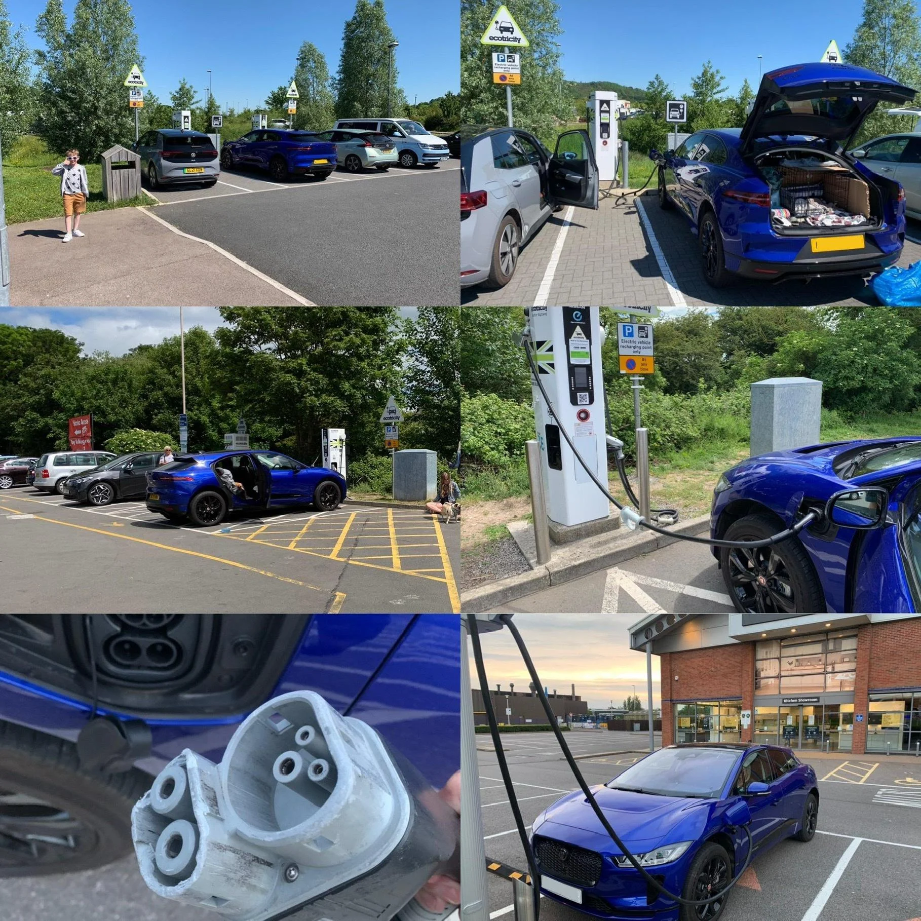

Day trip out yesterday so thought I’d see how I’d get on just charging when we stopped with dogs etc.
15mins at M5S Gloucester. Parked and an etron pulled up seconds after but he carried on as said wasn’t desperate. Then ID3 arrived and was happy to wait 10 for CCS. First time I used ecotrocity so was surprised space free and it worked ~43kW as I understand they have throttled them to improve CCS handshake.
2nd row of images is Sedgemoor, ID3 this time had beat me to the CCS so grabbed AC for 19mins of 11kW.

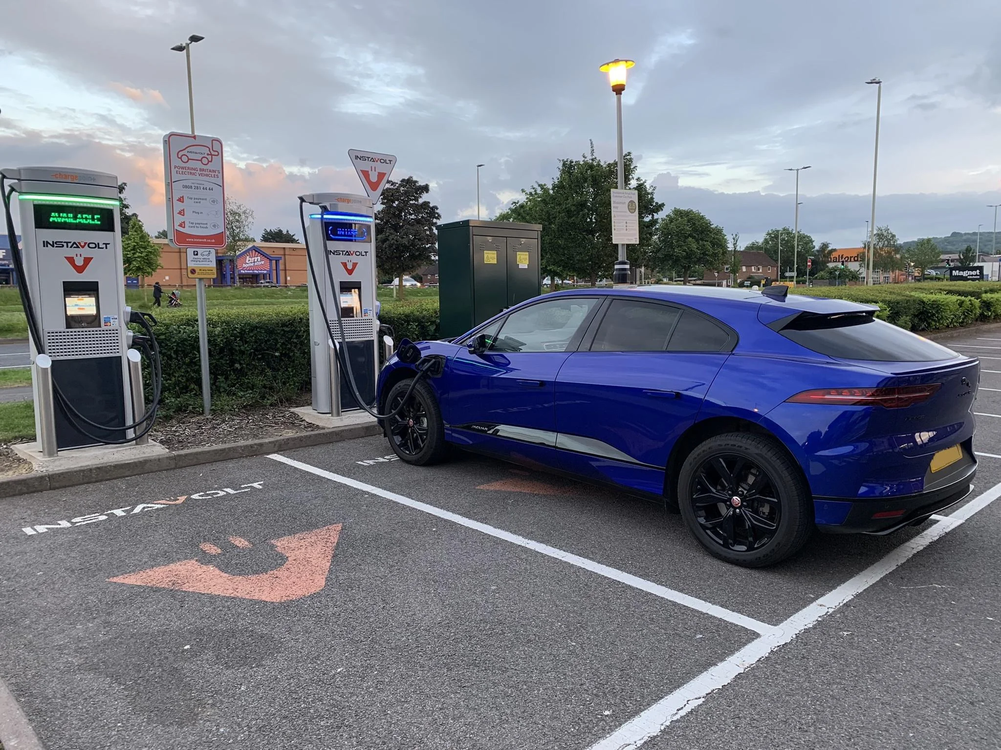

RETURN trip. Tried Gloucester M5 N but an MX-30 was just unplugging and EQC hooking up for 40mins so carried on to InstaVolt just off the motorway… at an empty Magnet carpark pretty much calculated enough to get home after 15mins of charging and dogs walked, McDonald’s round corner available but didn’t like this experience really.
Then on way dropped by Strensham to see if I could get an Ecotricty triple in one day, charger connector battered and it wouldn’t connected as the plug wasn’t secure, 4 attempts and it only start charging once whilse I was holding the connector home…. Stopped when let go. Amusingly the same MX-30 driver was there and came over to have a chat aswell.

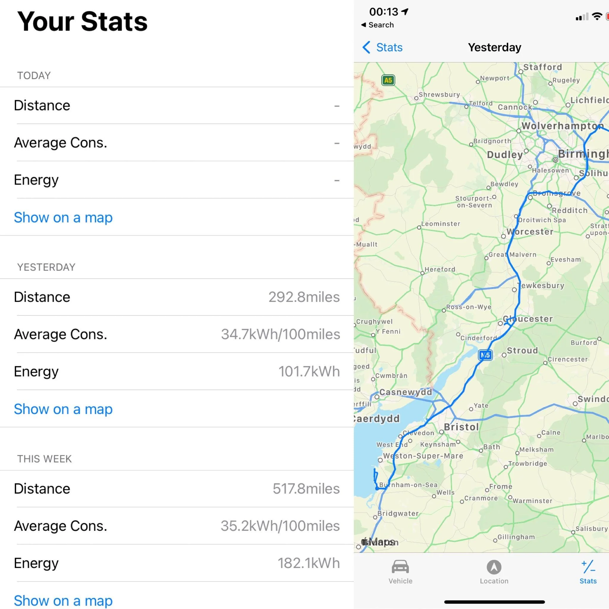

Started the day on 100% and added those charges just to top up. Dog/bladder only reason to stop on the way there. Then at Tamworth MOTO stopped to try new 120kW gridserve/ecotricity charger as on free vend. Only managed 65kW for the 13 mins I was there starting 8% but it’s only been in a few days.
Anyway just wanted to share experience of probably my first beyond a full battery day.

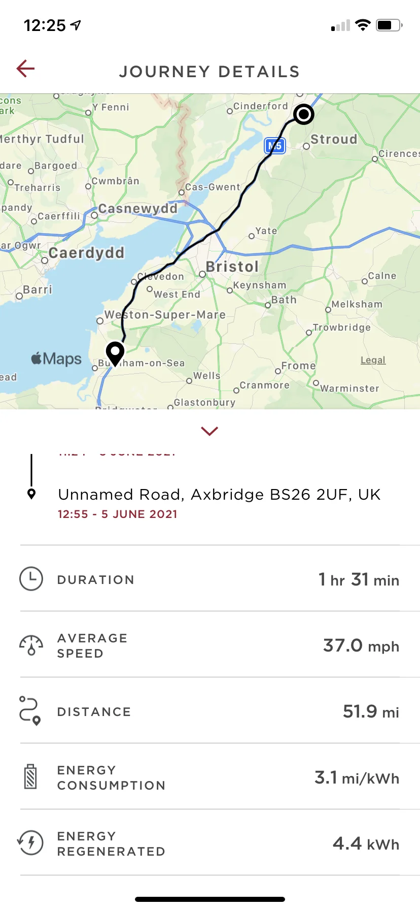

3.1 is about right for an iPace, they are known for being pretty 'thirsty' compared to a Tesla or Korean car. But at the end of the day it's a big car with big wheels and not the most efficient drivetrain, your just not going to see 4+ miles/kwh at motorway speeds. It compares very similarly to an EQC or an eTron, the Model X is more efficient but they cost £LOL or have a smaller battery so don't actually go as far (75D cars).
Indeed in the same way an F Pace would use more fuel than a Hyundai Niro. Once it’s 30mins or so you do see it really start to get into its stride as battery and oil etc is all at temp. The gearbox with cold oil is a bit of a drag. Shame for short journeys you can’t just tell the cars you aren’t going far to save it the potential of warm up etc.
So much capacity at speed though, 70mph and light throttle and it takes off like the V8s. Effortless.
Had a couple of 3.3 and 3.4 journeys and a best of 3.6 the other day. Just need to avoid the short squirts of power that like anything drag average down. Brilliant all round car, even the wife is warming to it.
Ah I see! I usually get 4+ and only see in the 3's if I'm doing 80 or so on the motorways so was surprised to see it down there at 3.1 is all. My knowledge on different EVs is somewhat lacking of course.
Still room for improvement though, as I said, the (much) bigger Tesla Model X is materially more efficient. Better efficacy means you can use a smaller battery for the same range meaning you can build more cars with the same resources.
Reducing consumption can have a wide impact, reducing consumption from electronics (via that pesky EU regulation) has had as much of an impact on decarbonising the grid as introducing renewables.
Surprisingly that model S was no more efficient than the IPACE, don’t know if it’s due to ludicrous using a lot of juice to warm the battery. Probably need to take it a longer run to test properly.
