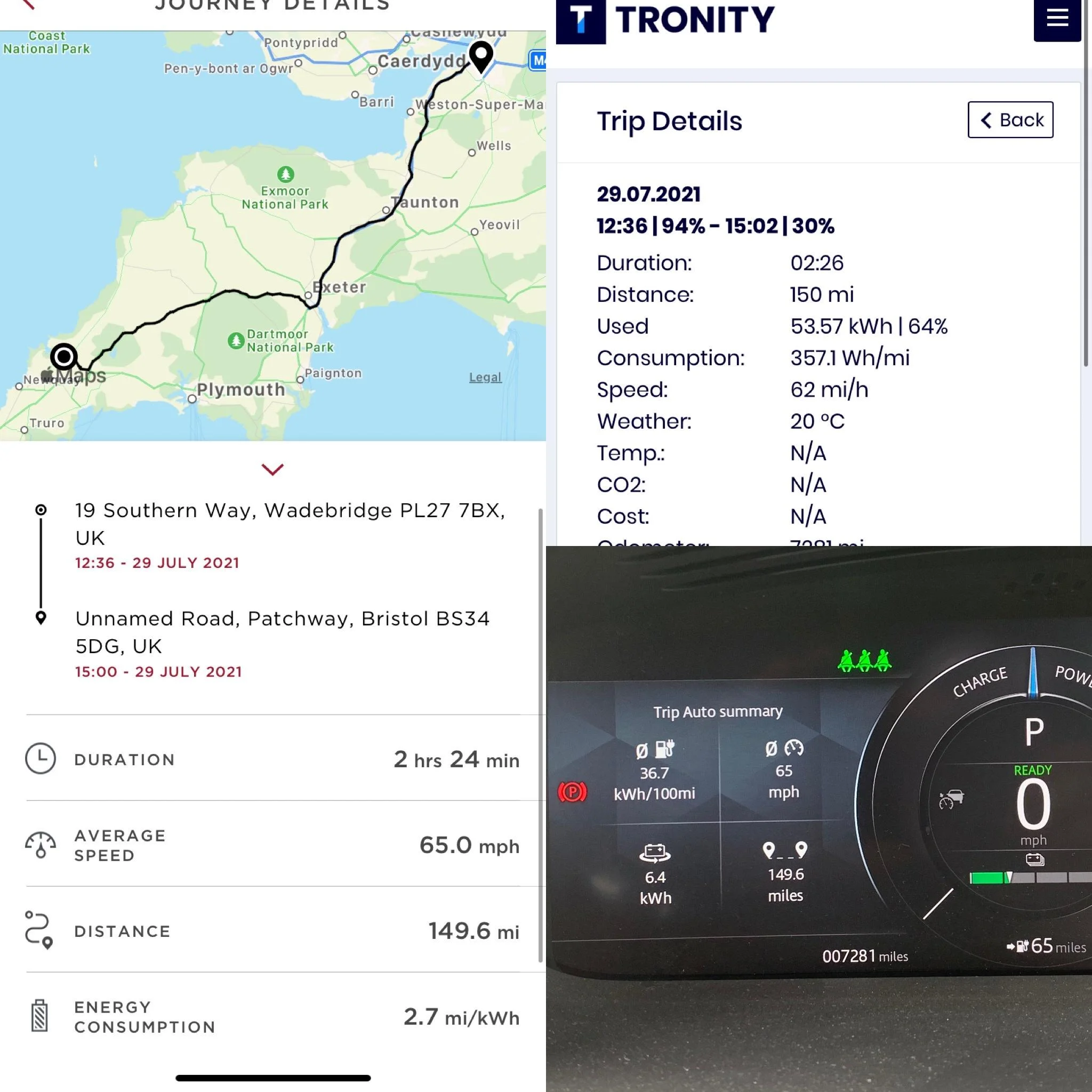

I returned from the South West today. Decent run trying decent A30 & motorway speed around 77mph cruise but often used the hills to build momentum :p only over taken probably 5 times so making progress as such.
The car has impressed me this trip, longer range with the battery at temp etc seems to pay dividends. Even fully loaded up with 5 people and luggage it’s effortless.
Planned to stop at Cribbs for quick wander anyway but I reckon in these ambient temps where the battery system isn’t trying to heat planet Earth in conjunction with the cells and then slowing down to 68mph or so I could have done it none stop. (65miles left as you can see and ~110miles to home).
The CYC/Source West charger at Cribbs Mall wasn’t playing ball so grabbed enough + headroom to get home at Mollies Diner again. 28kWh in 21mins ~ 80kW avg is ace for 30p/kWh. Especially as the bulk of the trip was free granny charge juice.
