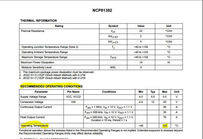

I mentioned in a previous post that reference cards use the part NTMFD4C85N to regulate the Vcore, these only handle ~85°C (maximum air cooled temp) and wasn't sure what the EVGA ACX versions used; it is the NCP81382.
Just to put some minds at ease, (see spolier for rated specs) incase you hadn't noticed it like me.

The GTX 1080 draws 180W+ at 1.05V, with the GTX 1070 drawing 150W+ at 1.05V. With factory OC'd cards pulling 1900MHz or greater, you'd be looking at something like 170-190A draw on the average GPU core, supplied by the VRM. EVGA is shipping its FTWs with 215W BIOS, which we discussed previously in our GTX 1080 Classified tear-down.
The GTX 1070 and 1080 FTW cards use NCP81382 power stages for each phase, of which there are 10 for the core voltage VRM. Working with Buildzoid, we have learned the following:
"These are rated to do an average 35A at 100C (so 350A for the core at 100C). What this translates to at higher temperatures like 125C, I don't know. The data sheet doesn't specify but other MOSFETs will lose 40-50% of their capability going from 100C to 125C. Assuming the same is true for the NCP81382, that would leave them with only 17-21A of average current capability (170A-210A at 125C). Toms Hardware managed to take thermal images of the VRM reaching 106C and measure 114C with a thermal probe. This was in bench test scenario with 22C ambient. In a case where ambient temperatures range between 30 and 40C depending on airflow, that 114C can easily end up 125C+. A VRM trying to provide too much current at too high a temperature will quickly end up like [the above from reddit]."
Confirmed here >> http://www.gamersnexus.net/news-pc/2661-evga-mosfet-failure-possible-from-thermal-runaway-scenario
As mentioned in the above link, a non-issue once people install the thermal pads and/or use the EVGA BIOS they issued, which adjusts the fan speed curve to improve VRM cooling.
