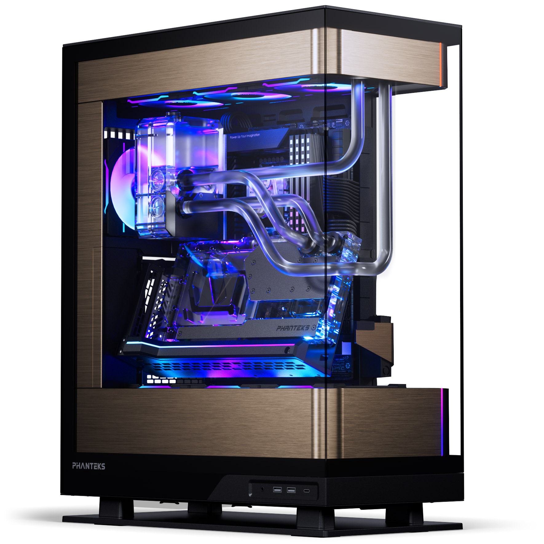

i got an Evolv Series X2 with the plans on going back to custom water in the photos on the OCUK site a assume provided by phanteks you can see the rad tubes exit at the front of the case.
i cant work out how the hell they did this. i dont see any way to mount the fans that would leave the front open for rad fittings.
dose any one have a custom loop in a Evolv Series X2 that can help please.
Do you mean this pic? At the front, top?
If so, they’re going into a radiator mounted at the top of the case.

i would have to cut the front 20mm of the bracket for the fittings to be assessable, with phanteks showing it this way round i just thought i was been stupid(as normal) and there was a way to do it.
