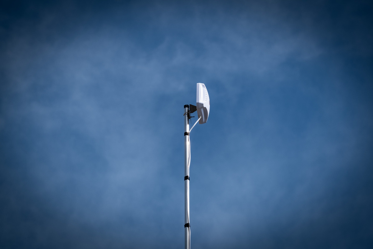

Got a Poynting XPOL-2 5G a few weeks ago £124, made a big difference to the router in the loft with bunny ear aerials.
Have it on a 10ft pole , side of the house.
Get speeds between 30-100 down and 30 up on 3 4G , not bad at all for £17 a month.

Thanks for sharing. Did you find a way to position it best?
Just by rotating it a bit, mate put it up in a rush, I'm going up the ladder when it's warmer and not windy to fine tune it, used the Huawei app for the signal graph and huactrl app.
