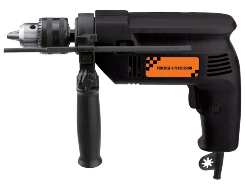

0000005150588_001c_v001_zp
Weight (kg): 1.8
Brand: Unbranded
Safety Cut Out: Yes
Keyless/Keyed Chuck: Keyed Chuck
Age Restriction Details: Not to be operated by persons under 18 years unless supervised
Age Restrictions: Yes
Warranty/guarantee: Warranty
Warranty/guarantee details: 1 year
WEEE Requirements: Elec & Electronic Tools
Manuf part no: UB500WID
No. of Drill Speeds: 1
Power (Watts): 500
Product Type: Corded
Corded/Cordless: Corded
Specific Product Type: Percussion Drills
£9.98 (CHEAP!), the store is around the corner from me....
This should handle a thin alloy case right?
