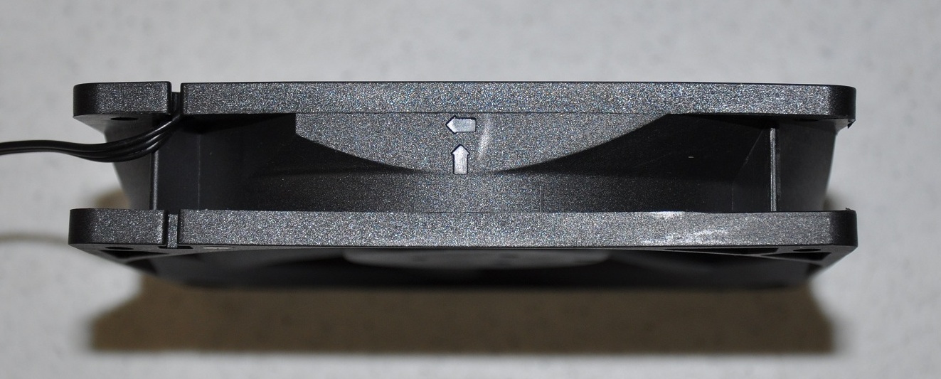

You sure non of the fans have something like this?
As above.

In this image the air would be blowing away from the viewer.
Usually airflow will move from the unframed side to the framed side. Blade movement is anti-clockwise.
