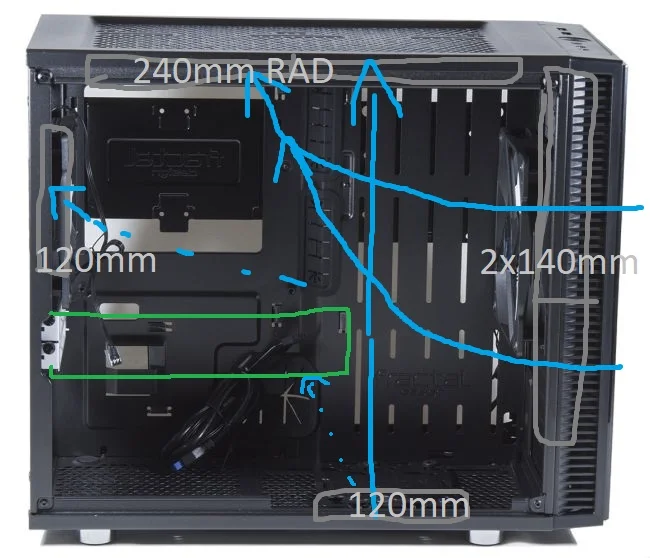

I think you need to try and visualise the airflow
(You'll have to excuse my MS Paint skillz :D)
This is basically what you currently have:
The rear exhaust is doing very little, as the flow from the front fans is going to be pulled up and out by the nearer fans on the Radiator, the flow from the bottom 120mm is also going to go straight up (further pushing the front air straight up). The bottom fan may help the GPU slightly, but not much.

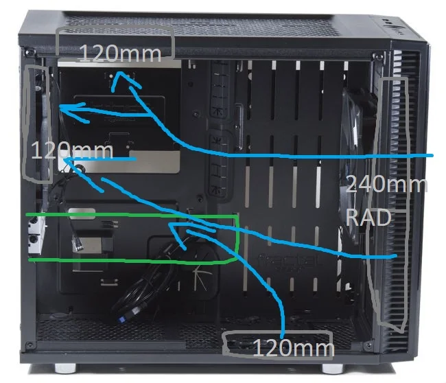

Personally I think you would get cleaner airflow with the aio at the front and removing the top(Front) fan:
By doing that you should pull more air across the GPU.
CPU temperature should also get a benefit due to being cooled by colder intake air.
Not sure if you can push/pull on that AIO, but may also be an option if further intake air is needed. (or if not then a 280mm aio is another option)
That's exactly what I have (good paint skills) except the GPU spreads across the whole area, so the bottom fan pushes air on to the last third(ish) of the card. The 2 140mm effective push air through the top half of the case and the bottom, if you assume the GPU effectively creates 2 zones.
There is no room for push/pull on a radiator and I moved the radiator to increase the airflow through the case over the GPU. Putting the rad in the front restricts airflow, so the bottom fan helps for sure as well. Does that make sense?
I like the idea of stopping the rear fan as things start to ramp up, and directing all air out the top though. I wonder how I can do an inverse curve...
I think you've missed the point a little. You don't want the air to be going out the top (especially at the front), as if it's going out the top it isn't flowing over anything (GPU, RAM, chipset, VRMs).
That's exactly what I have (good paint skills) except the GPU spreads across the whole area, so the bottom fan pushes air on to the last third(ish) of the card. There is no room for push/pull on a radiator and I moved the radiator to increase the airflow through the case over the GPU. Putting the rad in the front So the bottom fan helps for sure. Does that make sense?
It does make sense to some degree, but the bottom fan isn't really solving the problem - it's blowing a little air at part of the GPU, instead of having air pulled across all of the GPU.
I'd honestly try the AIO at the front again (even without push/pull) with your new fans it should still be better.
Even if there's less airflow in total, if it's directed in the right places it should be better ("airflow vs airblow" as someone else here often says). Leaving the top front spot empty is needed to ensure that the rear and top rear fans help pull air across everything.
