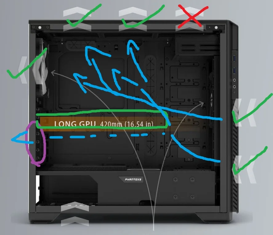

So I have 3x120mm in the front with the top 2 being on the inside to allow a little more space for incoming air. And then 1x140mm at the back and another at the back top. I miss the pump/block from my Kraken with its funky RGB but seeing as my case is sandwiched in a cubby hole, you can't see anything any way.
Edit - quick blast on Prime95 seems to be settling on 60c. Nice.
