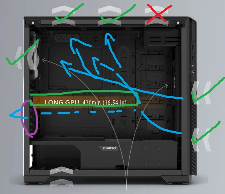

@Armageus - nice job on the diagram, posted about a similar issue in the Ryzen 3000 thread. My AIO is at the front, 1x120 at the back and 1x120 at the top. On a hot summers day whilst gaming - my PC gets very hot. I was thinking of adding 2 more 120mms at the top as exhausts but seen some people mention, skipping furthest front fan as it may steal some of the incoming front intake air. After some advice on OcUK, I think my GPU is the main culprit and the exhausts can only go so far. Haven't considered push/pull on my X52. @jsbombjack - let us know how your experimenting goes.
@doodah - What case do you have?
Phanteks Enthoo Pro M TG. To be fair it sits in a desk enclosure but there is enough clearance at the top for the exhaust and no door/block for the AIO radiator intakes. However on a hot day, the whole case can get worryingly hot (but temps within norms, just not particularly good).
I'd also still skip the top (front) fan.
Remove the PCI slot covers if you haven't already (even if they are perforated)
You will need Faster intake fans (or push pull) as generally you still want more intake than exhaust

I hadn't actually thought of the PCI slot covers, they are still on so will get them removed. As for fan speed, I haven't gone that granular as I just control everything globally through NZXT's CAM software (will have a look/see QFan control in the BIOS). Though I do wonder exactly how much cold air can be coming from the front of the case, as surely the radiator is going to warm it up?
With your case, it may be better to have the AIO at the top (as that will restrict exhaust to some degree anyway) and you only have 2 intake positions vs jsbombjack's 3.
Again, it's all trial and error - some things work better than others depending on the case, and the specific hardware and fans you have.
Cheers :) - happy to do a bit of trial and error.

Just thought - I know my Kraken X52 is a 240mm but I am pretty sure the front panel of the Enthoo Pro M has space for 3 x 120mm fans. Could potentially fit a third at the front, move the rear exhaust 120m to the top (so 2 x 120mm at the top). Either leave it like that so there are more intakes than exhausts or possibly put a 140mm at the rear exhaust.
Not according to their website. But if it is then 3 at the front, 1 at the rear and 1 at the top would be my suggestion.
It does, just in a bit of a janky way :D:o....
Previously the two fans were screwed directly onto the radiator, I can't do that with three. But I can screw the fans to the case and the same for the radiator (made sure the long screws aren't in a position to damage or puncture the radiator). Admittedly each fan is only attached by one screw, will keep and eye on it and see if I can come up with a solution to keep them in place.
