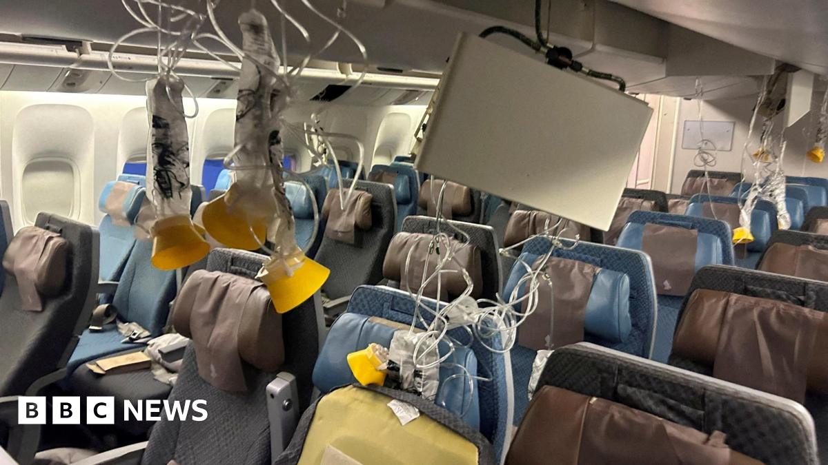

Reports today saying that "A Singapore Airlines flight hit by severe turbulence experienced a rapid change in gravitational force and a 54m (178ft) altitude drop in four seconds, an investigation has found."
WTF? Hitting a patch of low air pressure and falling a bit I can understand, but I've never seen a mention of gravitational force in relation to turbulence before...
Negative G as it dropped and the passengers and aircraft were subjected to a negative g force.
