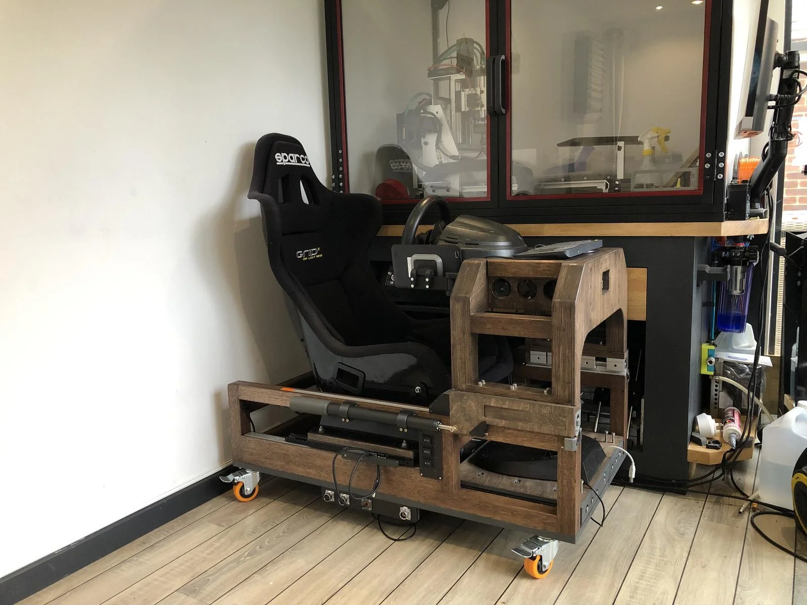

Zeeflyboy, you could always make one of these
I’ve been tempted, but the 6 axis machines really need a decent dedicated space for them which I don’t have.
I have however just taken delivery of a thanos motion controller, so my compact rig will be getting motion (SFX-100 style) as and when I can afford to build all the actuators.
